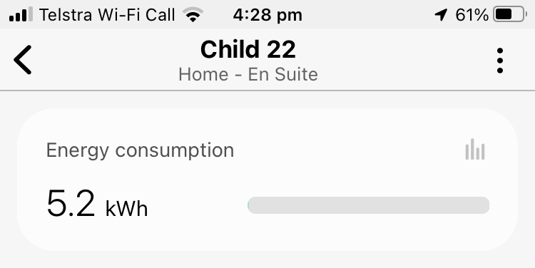

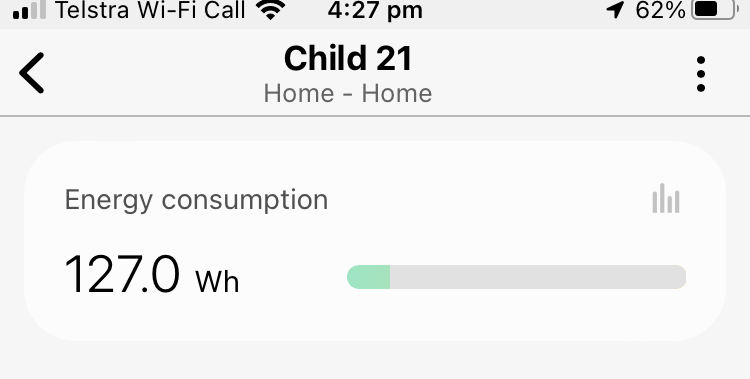

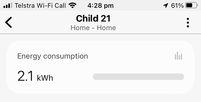

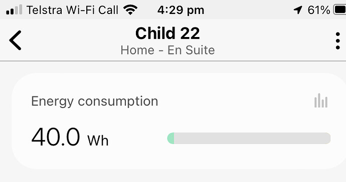

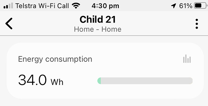

Hi Wesley, it seems that datapoints 21 and 22 give me live readings of total power usage across the 3 gang switch although they do not seem to match - I’m not sure which one is correct.
Fan switch:
Heater switch:
Light switch:
Not sure what datapoints 20 and 23 do as they remain fairly static. Tried them in both Energy and Power meters but same result.
Ok, I think 21 is energy usage and 22 is current.

Hi Wesley,
I’ve spent some time investigating this and here’s my findings:
Values 22 is real-time Energy Meter (Wh) and Value 21 is real time Current Sensor (A) across the entire switch. Value varies dependant on which switches are active. Can clearly see the difference in power draw between LEDs, Fan and Heater. I did the W to A calculator to confirm which value is which.
Value 23 is the Voltage Sensor (V) as value is always around 240VAC, dropping slightly when switches are on.
Value 20 creeps up very slowly over time - possible total power consumed-Power Meter (W)?
The only one I’m not sure on is Value 20 as this shows as a total usage of 7W…not sure if that is correct value (W).

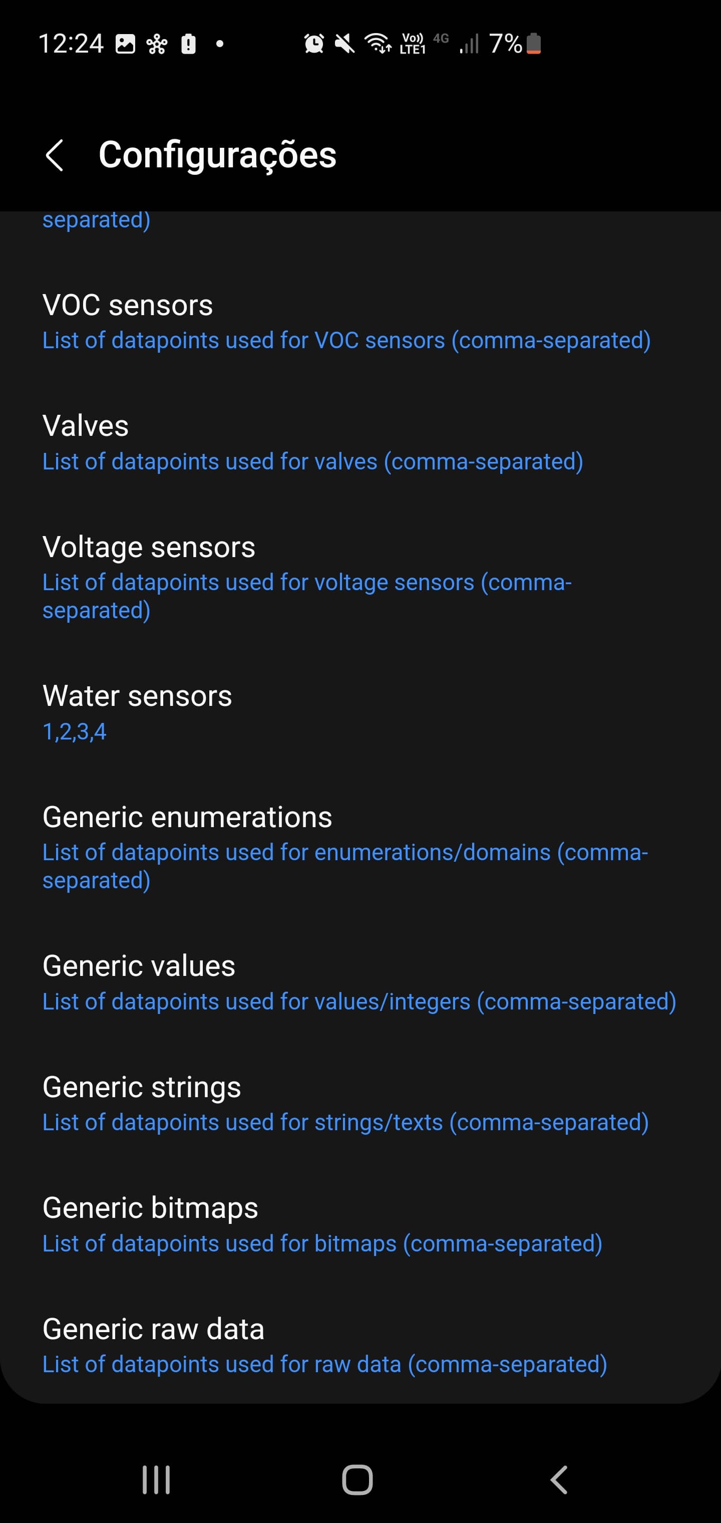

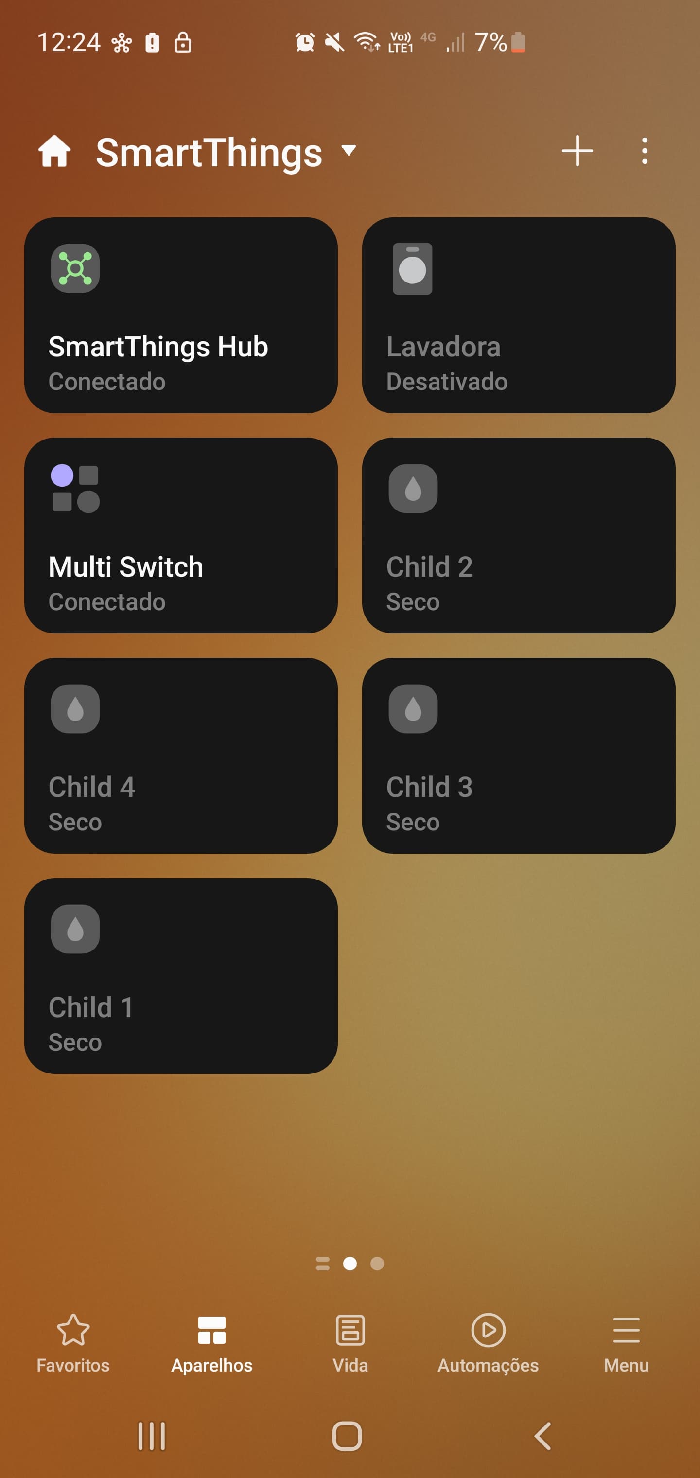

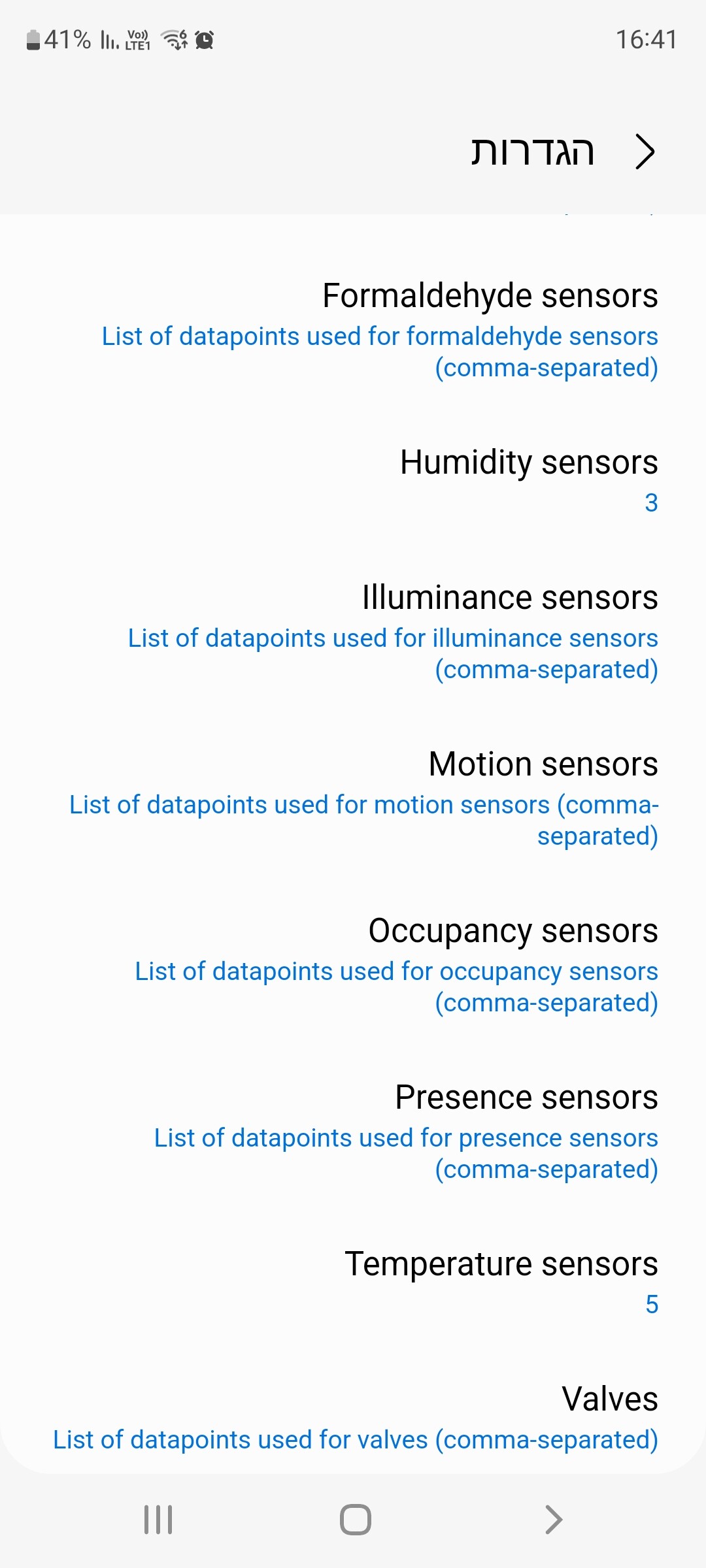

@w35l3y @OferDV I’ve got the soil sensor connected, it connected first time, although I’m at a loss how to use the driver correctly. I input some values, and 4 water sensor child devices were created, one of which correctly changes wet/dry when the sensor goes in water, so I can delete the other 3 child devices. How to get moisture percent?
Each datapoint has a meaning.
In your case, complementing what @OferDV said:
DP 3 = Humidity sensor
DP 5 = Temperature sensor
DP 14 = Battery state (0=low,1=medium,2=full) - it currently doesn’t exist in this driver.
DP 15 = Battery percent
So, you shouldn’t use water sensor, but the ones informed above.
Water sensor is used for detecting leaks.
I just didn’t understand how it created 3 generic sensors even though you added as water sensors.
I tested it here and 4 water sensors were created.
If you only need DP 3 (Humidity sensor), then only inform it.
Put some water in the sensor, and it should change “Connected” to something else like, for example, 83.0%.
