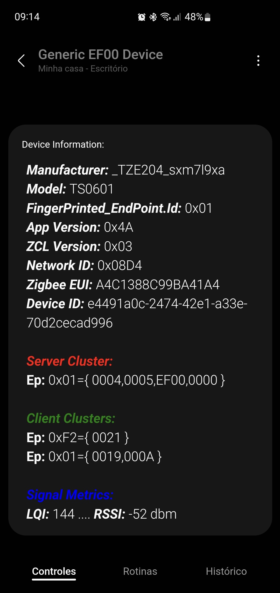

Hello can you include this fingerprint? It is a tuya presence sensor like the image below.
Tks dude
This is the exact device requested right above yours.
It already was added.
It should be available in the next 12 hours.
