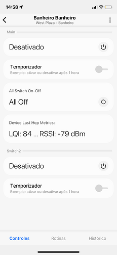

I have a multi-component device and I see the switch capability appears for each component

It should be ok in Routines, please share a screen capture of the deviceâs detailed view and how it looks in the Routines tool.
I have an Edge driver that creates a device with three components, each with a momentary capability. In ActionTiles, which has a Groovy based connector SmartApp, the components are presented in the device selection lists as if they are separate devices and momentary tiles can be created using them. They just donât work.

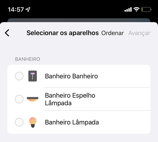

So⌠there is not much to show in Routines. I have only a single switch with the Main´s name.
And for Smart Lighting I have the same image that @Mariano_Colmenarejo did post.
This device âBanheiro Banheiroâ os a 2 ganha switch with @Mariano_Colmenarejo mukti-awirch edge driver.
However, in Routines I have only the Main available to select.

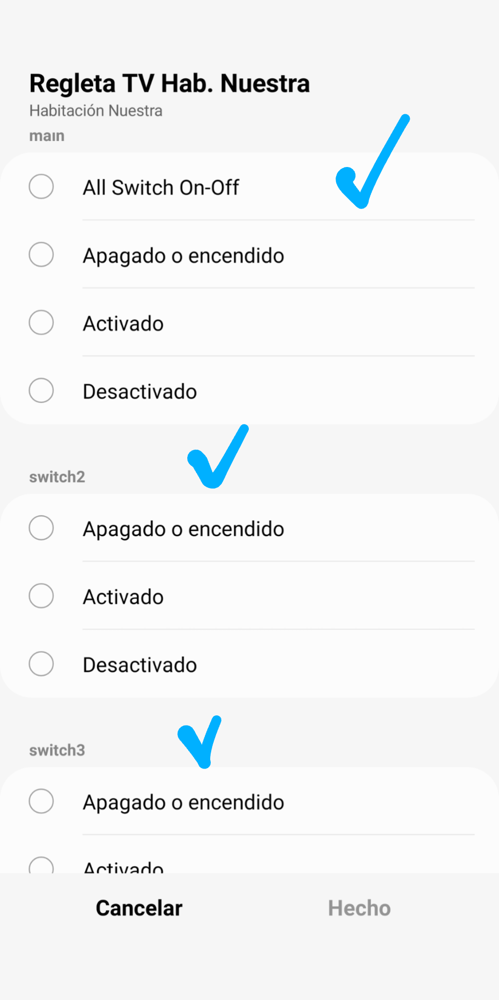

In automations You must select the multicomponent device and then it shows you all its components with the conditions or actions
IF part:
Then part:
Thatâs what I meant by smart lighting app, you can select the components as if they were separate devices and create the automation, but it doesnât run.
On the other hand, as in multicomponent switches you can only change the name of the Main component, all the secondary components have the same names, switch1, switch2⌠and you donât know which device each one belongs to.
