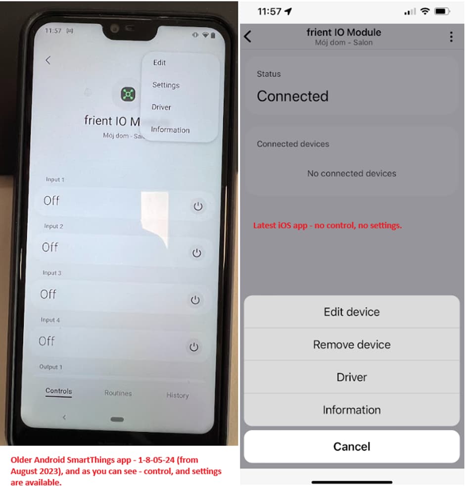

Hi.
Here’s the same device on the same account, same driver, and same hub, but on two different app versions.
Latest, iOS SmartThings app.
As you can see - no control, no settings available.
With the older Android SmartThings app - 1-8-05-24 (from August 2023), and as you can see - control, and settings are available.
This is happening in the “Bridges” device category.
Is this a bug, if yes - when will it be fixed?
Thanks in advance.
It looks to me that the Frient IO Module is being implemented as a multi-component device rather than a bridge in the SmartThings sense of the word so I don’t really understand why a Bridges category would be used. It would appear that the latest version of the app is giving precedence to the Bridges category over any other presentation the device has.

Yes, this is a frient driver.
The driver was working fine until one of the latest SmartThings mobile app updates.
Since then, you can’t do anything to control it (you can still use routines though).
Could I get someone from SmartThings to put some position of theirs into that?
