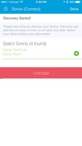

Look below it identified 4 Sonos (one is the BOOSt so not technically Sonos play 1). But for ST purpose, I chose only 2. The living/family room one is a pair and I chose only one.
