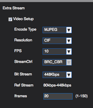

update. I played with the settings on the camera and now it seems happy. They look like this now.
