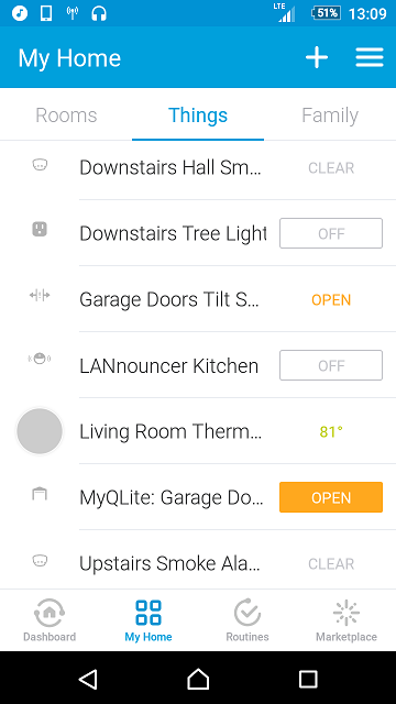

Noticed a problem though. I have a garage door opener automated thru the excellent MyQ Lite smart app. I can make it show as both a switch and a contact sensor in SmartTiles.
The problem is that while the sensor tile always reflect the correct open/closed status, the switch tile tends to get stuck in “off” state. Thus is, if the garage door is actually open, the contact will show as open, and the switch will show as off. Toggling the switch twice will refresh it (and will close the door), but after awhile it becomes “off” and stale again, regardless of the door being opened and closed thereafter.

What value does the SmartThings mobile app show for this switch? SmartTiles doesn’t know anything beyond the values in SmartThings cloud.
Sorry, I neglected to mention right away that the SmartThings mobile app DOES show the correct, up-to-date status of the device.
I just opened the doors. Here is what these two tiles look in Smart Tiles now:
And here is the picture I see in the SmartThings Android app. Notice that the “MyQ: Garage Do…” IS open:
As does SmartTiles… The Door Contact Tile is showing Open.
Does that SmartThings Tile have Sub-Tiles? We need to see the stare of the Switch portion.

Thanks for the quick response! Yes, the Door Contact shows open, and it’s great. It’s the Switch tile I am having a problem with.
I began looking at the logs to harvest some events as the example, and then realized that although the DH claims both Switch and Momentary capabilities, it only sends event updates for button (momentary), door, and contact. As @Mbhforum observed in another thread, the tile in Smart Tiles must be exhibiting a momentary switch behavior, which is what should be expected, I guess. Meanwhile, the contact tile works fine, as we already established.
Coming from development background but being a novice to ST, I see two possible ways to fix this issue:
- MyQ Lite should begin publishing switch events, or
- Smart Tiles should begin consuming MyQ Lite’s door events
Good observations, thanks @Gorilla800lbs…
The correct answer is “both”:
If MyQ Lite DTH claims “Switch” Capability, then it is obligated to send
switchAttribute Events. -
SmartTiles is highly likely to offer “official” Garage Door Control Capability support in next generation (“V6”).
