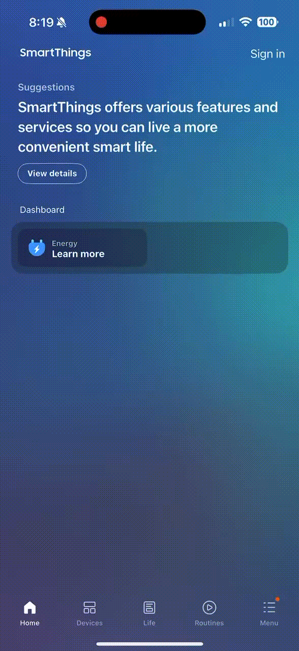

ScreenRecording_06-22-2025 08-19-08_1
This is what it’s doing. I tried reporting this to Samsung via their chat portal and they tried telling me it’s my browser cache or some such nonsense. This is an issue with the security of their account login page but reporting the issue to the right people seems to be near impossible. Their front line tech I was chatting with refused to escalate the issue.
