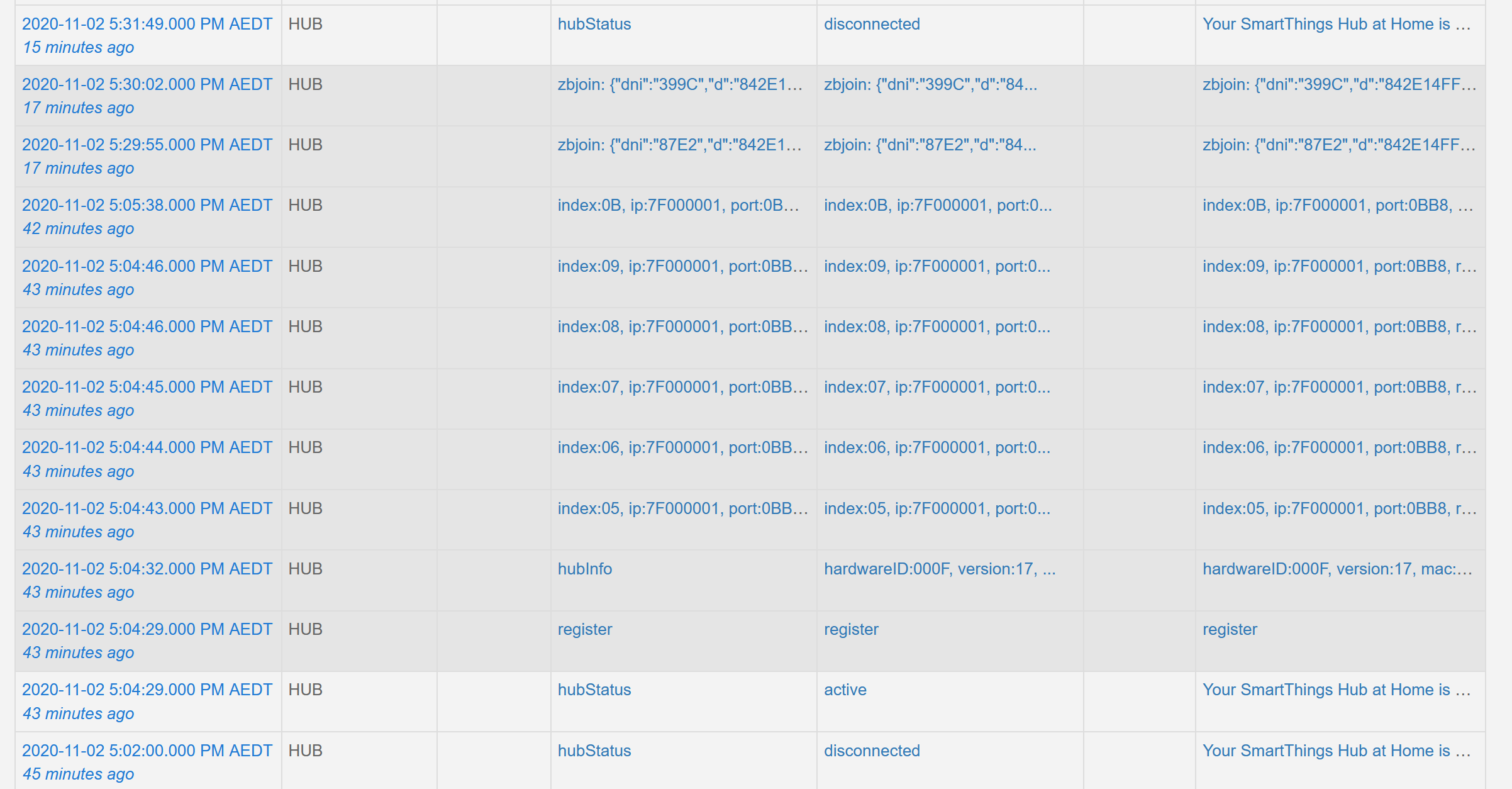

Chiming in as another Australian user with the exact same problem. I believe the problem started for me sometime on 30 October. My hub’s “Events List” in the IDE shows the following pattern of events every three minutes or so:
And nothing has worked properly since this started.
This is using a v2 hub, US model. It’s not a local network / ISP / internet connection issue (connection is rock solid, nothing else exhibiting issues, have tried alternate network cables + switch ports). Have also tried rebooting the hub via the IDE, and via pulling the power cable (including at one point leaving it unplugged for a few hours).

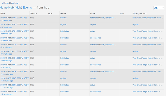

(putting this in a separate post due to new users only being able to embed one item per post):
Occasionally I will see some different events pop up in the “Events List” and/or a slightly longer delay between the events in the active-register-disconnected cycle, which sometimes coincides with devices partially (I stress partially) working for a brief period. e.g.:

Yeah, my logs are the same as @heftodaa above. I have an Aussie model V3 hub.
