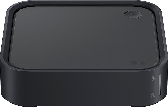

  3. Follow developments in Matter and at some point add this Smartthings Station to my system:
    Amazon.com: SAMSUNG SmartThings Station with Power Adapter, 15W Super Fast Wireless Charger, Smart Home Hub, 2023, EP-P9500TBEGUS, Black : Cell Phones & Accessories
    Will I still need the V3 hub when I get the Station device?

The v2, V3, and Station all handle matter over Wi-Fi and matter over bridge the same way.
If you want to use any matter over thread devices, then you have to have a “thread border router.” Many people already have these because they are built into some echo models and some Google nest models. They are also built into the V3 and the station. So the only time you’d have an issue is if you only had your V2, and then you would have to also get some thread border router. Which could either be one of the smart speakers, or could be a smartthings station.
But you don’t need to use thread to use matter. thread is primarily intended to be used with batterypowered matter devices, because Wi-Fi typically has too short of a battery life. But another alternative is to use zigbee batterypowered devices which are connected to a Matter bridge. so no one can say upfront whether you will ever need Thread or not. You would only need thread to communicate with a device that uses thread. It’s up to you whether you ever buy any of those or not.
If you want to stick with an all smartthings setup, that’s up to you. It’s also up to you how many ST hubs you want to have. But if you go that route, you haven’t done anything to protect yourself against the problem that caused you to start this thread in the first place. It could happen again. I’m not saying it will, but since we don’t know why it happened in the first place, we don’t know whether it can happen again. :man_shrugging:t2:
Oh, and again, the smartthings station doesn’t have zwave support. The V2 and V3 hubs do. So if you want to use zwave devices, the station by itself is not enough.

After further thought, I decided to add the Samsung Station to my system (in addition to an Aeotec hub). My plan is to put my Z-wave devices on the Aeotec hub and everything else on the Samsung station. Currently, this includes apps such as doorlocks, doorbells, thermostats, Alexa etc. Now, while I’m waiting for the devices to be delivered, I need to figure out the process for getting this done properly to minimize complications.

If I were to put Z-wave and Zigbee devices on the Samsung (V3) hub, does it still make sense to have a Samsung Station hub? In my case, that would mean using the Station only for apps like Doorbell, Doorlocks and Alexa app. Would that be better or worse than having everything on the V3 hub and eliminating the Samsung Station? I understand that there may be some special features in Station that work with Samsung Galaxy phones (which I use). But are there benefits beyond that?
I assume the doorbell, door locks, and Alexa are all Wi-Fi connections? If they’re cloud to cloud, Wi-Fi connections, they don’t use the hub anyway.
If they are matter over Wi-Fi connections, then they will be local to the hub.
As far as having a station, if you already have the Aeotec, some people do, usually if they are trying to separate zwave and Zigbee, in order to reduce the number of custom edge drivers on each hub because they’ve been running into memory issues.
Or, because, as you mentioned, they have a galaxy phone, and they want to use those features and the phone charger aspects of the station.
But otherwise, it doesn’t sound like any of your Wi-Fi devices Need your hub at all. Ring, for example, is a cloud to cloud integration with smartthings, never touches the hub. :man_shrugging:t2:
Also, just for clarity, the smartthings hub (any ST hub) doesn’t run any apps. It runs edge drivers and some routines created through the smartthings app and then downloaded to the hub. But that’s it.
