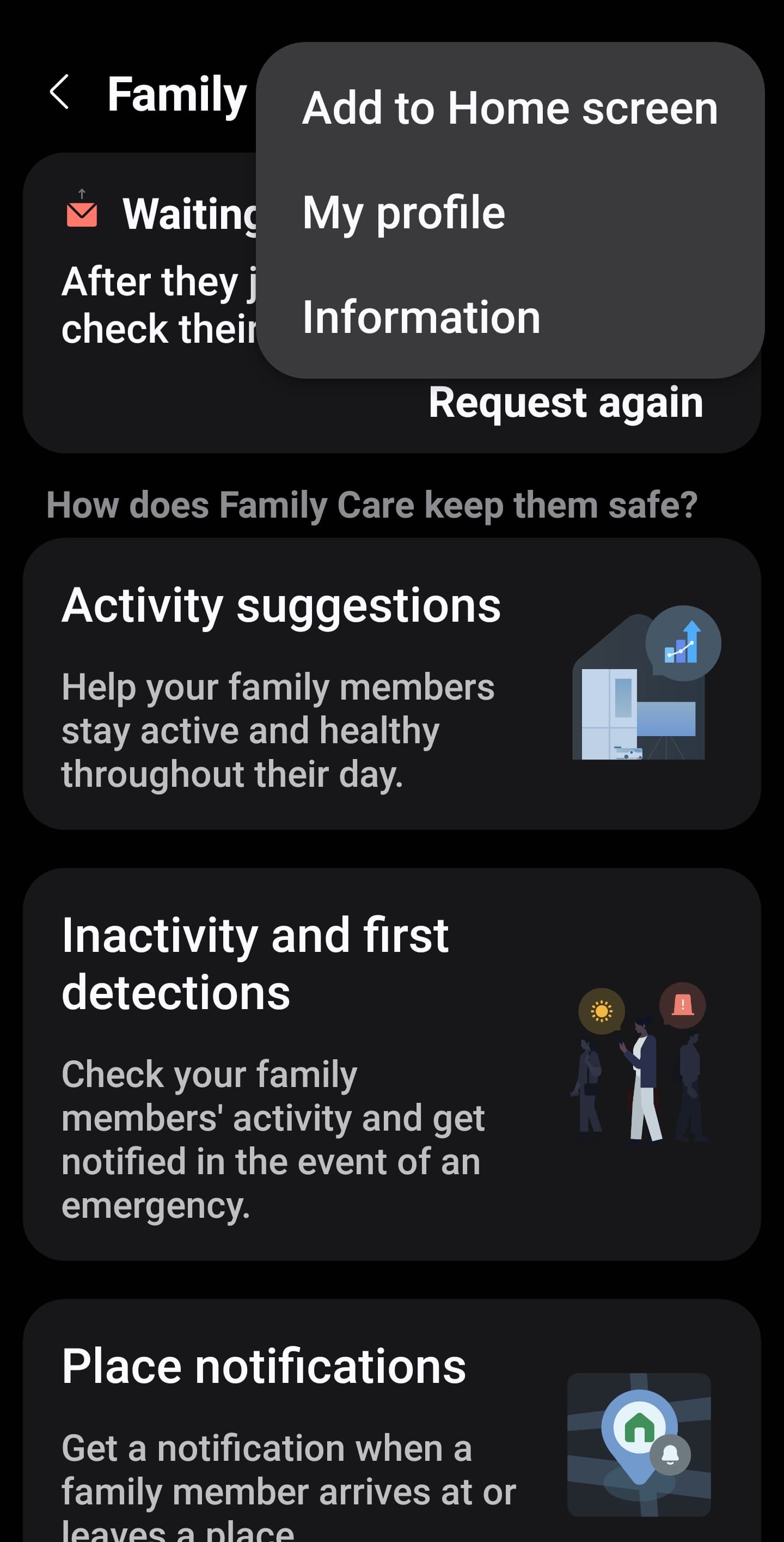

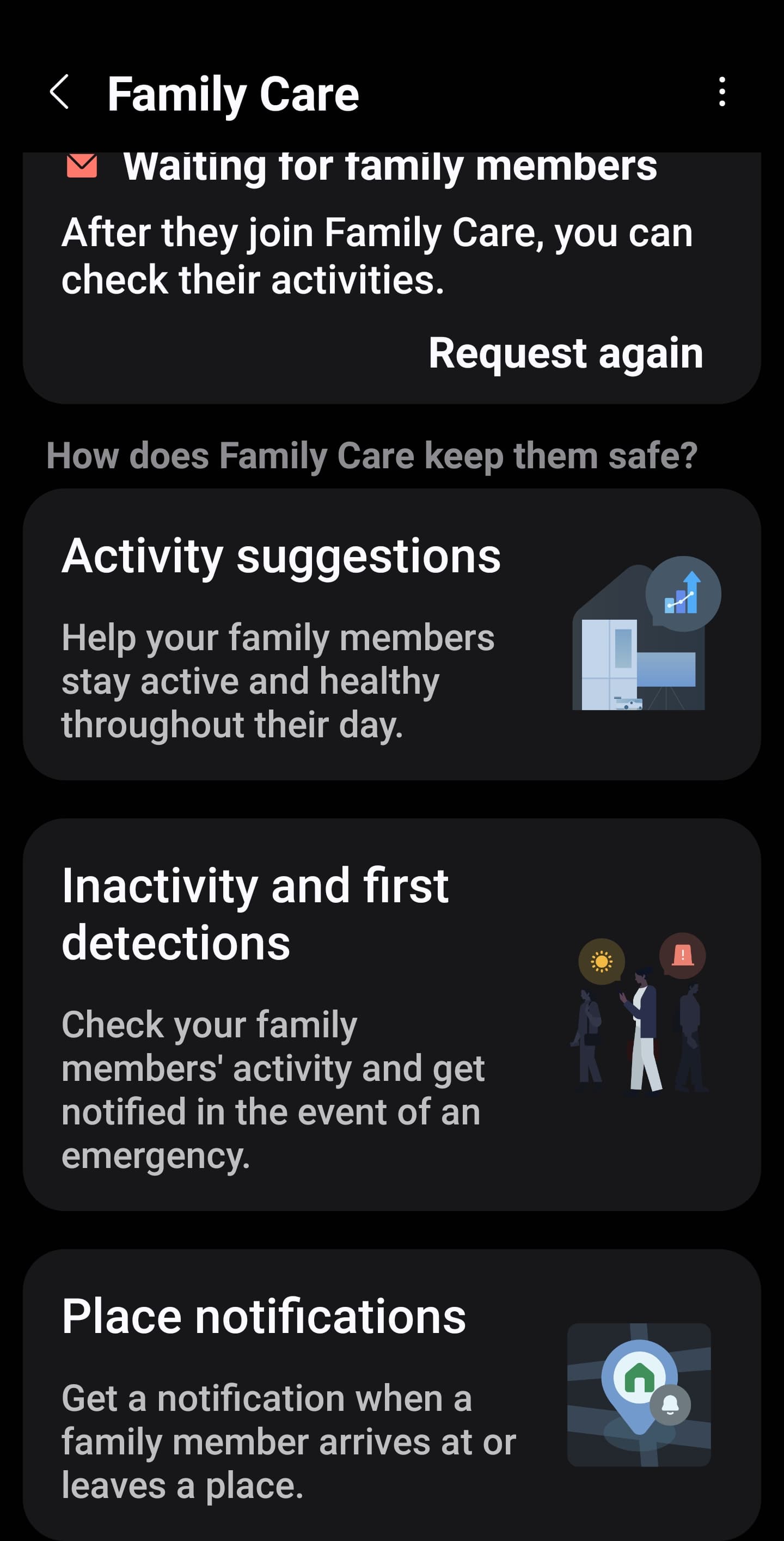

only place i see something concerning, leaving or arriving at a place, is from within the Family Care feature in the Life section, however, once ive downloaded the Family Care feature, i dont have any selections or things to change.
