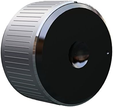

The highest rated is the August pro three, which supports Z wave and Bluetooth with its Bridge device.

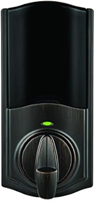

And then Kwikset recently introduced a new model called “Convert” Which is a similar style. I haven’t heard much about that one way or the other yet. (do not get the “Amazon key“ model; that one does not work with SmartThings. Get the regular Z wave model.)
All of these come in multiple colors.
If you use any of these three models, you do not change the exterior hardware for your lock. So you have to have a smart phone to use the lock from the outside. Or you have to add a separate keypad device.
I really appreciate your prompt feedback. Will I still need August’s connect bridge if I have ST hub? Also my original door lock close and opens many deadbolts all over the door, so will augusts motor can easily open and close those? Affect battery?
Sorry for my newbie questions.
I guess August wont work as well. Its only compatible with deadbolt locks and not euro style cylinderical ones.
