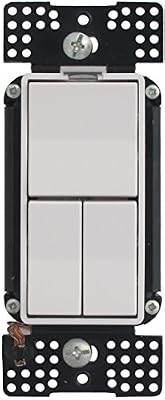

I was looking to replace a few single rocker and double rocker switches like this:
With something that can be connected to SmartThings. I can always put a relay behind the switch, but I figured it would be neat to have a single button or double button “switch” which could communicate with my Hub and also still toggle the power to whatever is wired into them from behind. I liked the idea of a connected button instead of a switch so that, if the device is turned on via ST, it doesn’t mismatch the switch.
If I understand this comment correctly, you won’t have an issue as all of the network switches are momentary devices anyway. They don’t lock into up for on and down for off. Instead, you press up for on and then the device returns to the center resting position. Or you press down for off and then the device returns to the center resting position. But it’s always resting in the center, so it doesn’t get out of sync in that sense. Even the toggle switches do that.
I may have to end up using micro relays behind existing switches because going from the rocker to a traditional toggle like that definitely won’t pass the WAF here. Or I just wait it out for a 2-button switch similar to Leviton VRCS2-MRZ (RIP!).
Sorry if that wasn’t clear, the traditional rocker format is actually more popular for zwave switches. Again, the switch rests in the neutral position, but it’s less obvious with the rockers. There are a number of different brand that sells the rocker style.
