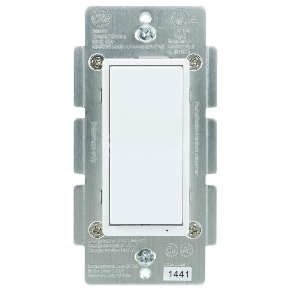

I think about the only thing you will find with those restrictions are the GE zigbee versions of their smart switches, and you have to wait until they are on sale at Home Depot or Lowe’s. They are more typically right around $42, but they do occasionally go on sale.
Here is the manufacturer site. GE licenses its name to Jasco for smart devices.
