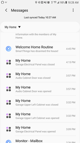

I use Notify Me When, but I use the standard status message format, and that tells you which device in the message. Works perfectly. Are you providing a custom “Message Text”?
Here are examples from my set up: (My Home)

Awesome! Having the custom text in my notify me when rule removed the device name and status from coming across. Removed custom text and looks good, just like yours!

Using the image in my reply above, “Monitor - Mailbox” is an ST built in Automation that uses just one device, so for me if I’m just monitoring one device I’ll use automations, otherwise it’s the notify me app. Complexity of conditions may also come into play.
