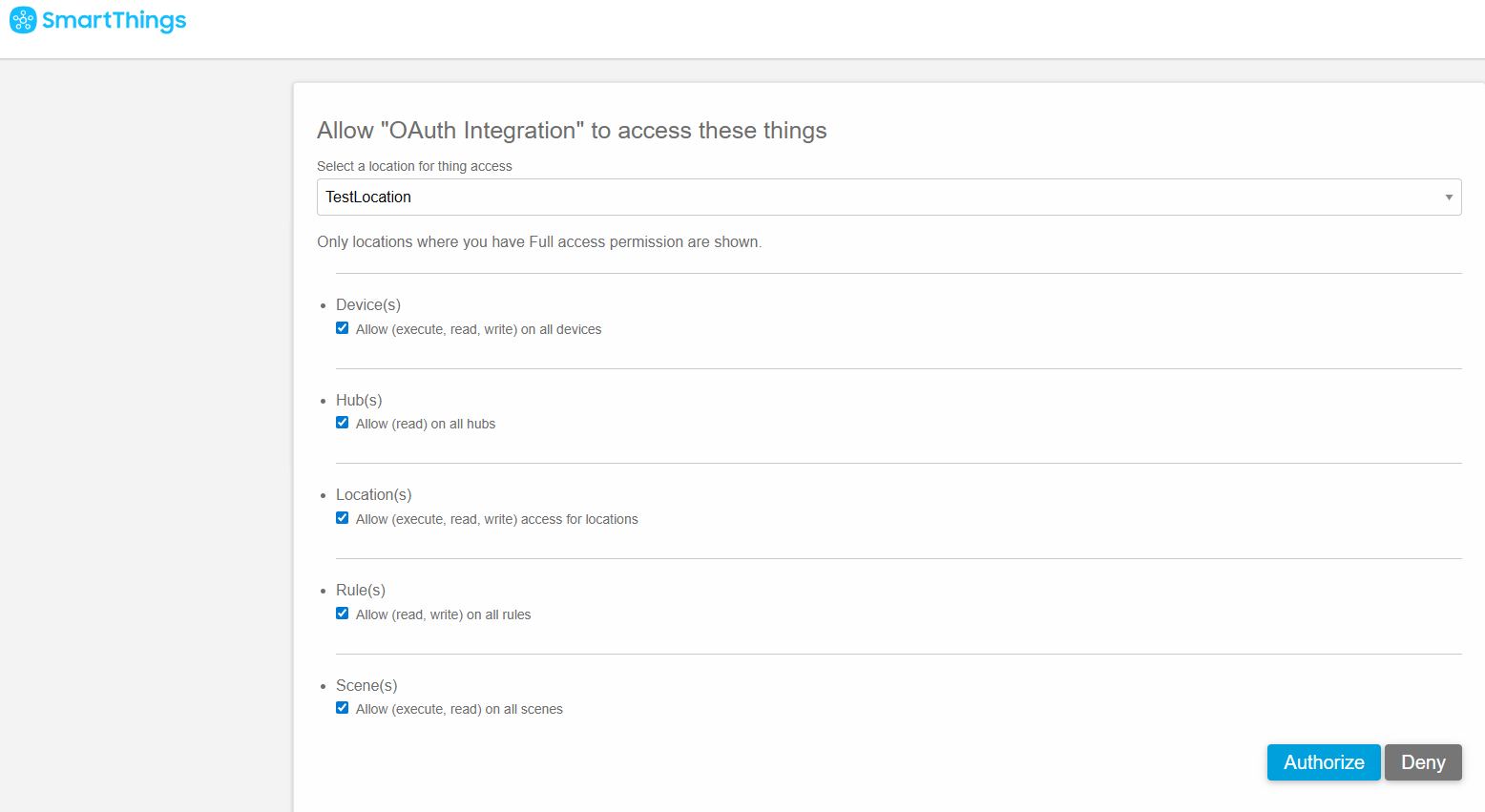

I’m guessing it is, but I don’t know exactly how their integration works. When you integrated their cloud, did you go through an authorization process? It would be a page like this one:
If so, if you selected only the Samsung device, it makes sense that only one appears. If you, as in the sample, selected “All devices”, then, the token adquired by the cloud should have access to all the devices in your location.
If you have a valid Access Token that allows you to interact with all devices in your location, you should be able to make API requests (depending on the authorized scopes) to do so.
