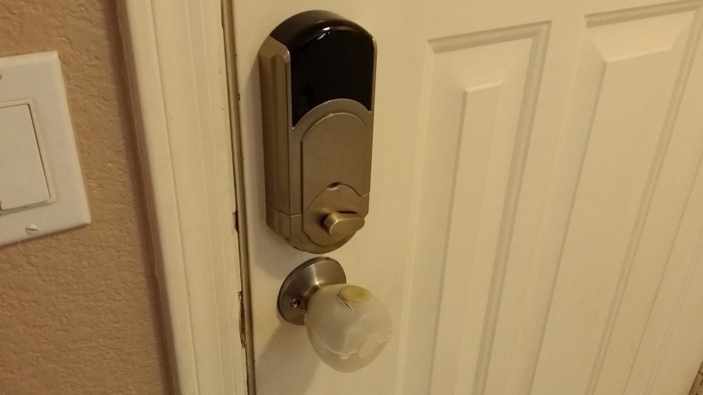

That looks in the picture just like the US model which is a deadbolt. However, the UK version is not.

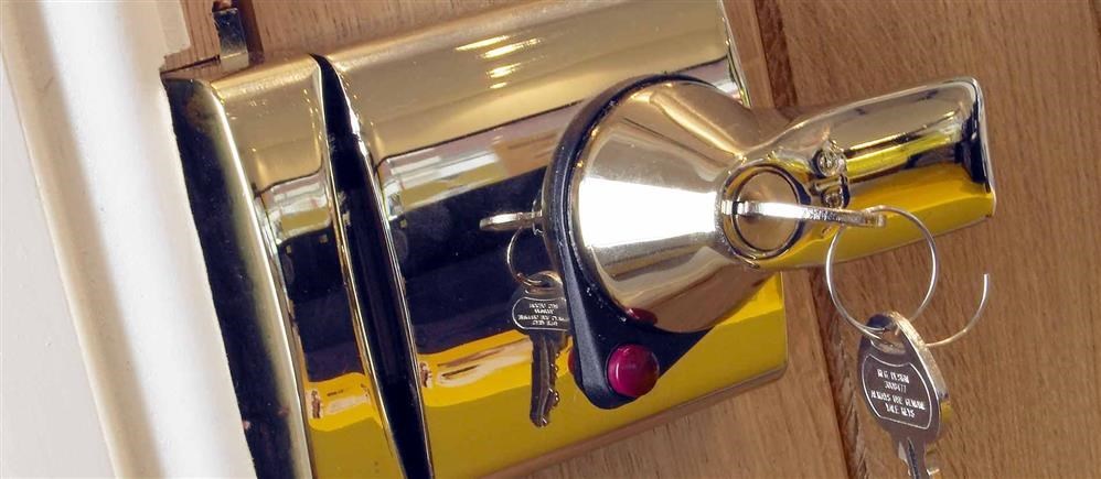

Replaces existing rim cylinder used on a 60mm backset nightlatch*
Door locks in the UK are very different from typical residential door locks in the US, in part because of the number of different types of doors in the UK due to the age of some buildings.
Typically, a nightlatch fits on top of the door and the bolt goes into a Metal pocket which is attached to surface of the wall/frame.
This is different from a deadbolt which is interior to the door and goes into the frame.
Notice with the deadbolt there is no corresponding pocket piece, because the bolt goes inside the wall when it is extended.
A deadbolt is considered somewhat more secure than a night latch. However, there are quite a few doors in the UK which don’t allow for drilling into the door/wall itself, so a deadbolt can’t be used.
there are also “deadlocking” Nightlatches, which we don’t have in the US because they would violate the fire safety code in most jurisdictions. With these locks, you can lock the latch with the key and then it cannot be opened unless another key is used. In contrast, in the US, most places require that a residential lock be able to be opened from the inside without a key, specifically to allow for exit in case of a fire.

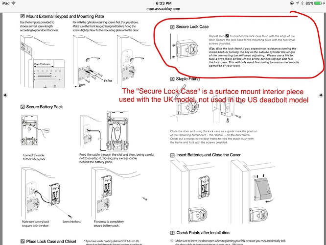

Seems odd that they would list a US lock on their UK website doesn’t it?
I don’t think it is the US lock. I just think it’s the same case. So it looks the same in front on picture, but it is installed differently as the detailed product description on that page explains. Assa Abloy, who own Yale, use a lot of the same case parts throughout the world, but with different lock mechanisms.
Here’s the installation guide for the UK model on that page. You can see that the exterior piece, which is what is shown in the picture, is the same look as the US model. But the interior piece is definitely a surfacemount night latch and installed very differently.
http://mpc.assaabloy.com/yalefile//Fetchfile.aspx?id=25055&dl=1
In other words, RTFM!
