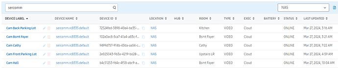

This behavior seems to indicate that the cameras are already registered on your system. I’ve had to reset them in the past to change the WiFi SSID, but I left them installed/in-place, named them the same as their prior names, and life was good, keeping all of the Routines/Notifications that I had set.
Are they showing Video, Cloud, and Online (as mine are shown in screenshot below) ?
If you “can” rename them or change the room they’re in while on MySmartThingsAdvanced, are they then showing up in your Phone App (after exiting & reloading the Phone App) ?
If still no luck, consider using the Trash Can (remove) icon in MySmartThingsAdvanced, then re-add.
Please report back all itemized observations above
If you’re not finding any “sercomm” devices, can you review ALL devices and see if there are 4 unknown/suspect devices that are showing up as something else? Perhaps delete those and try again. Just be extra careful that you’ve identified all of your known/working devices and that these 4 are the likely offenders
