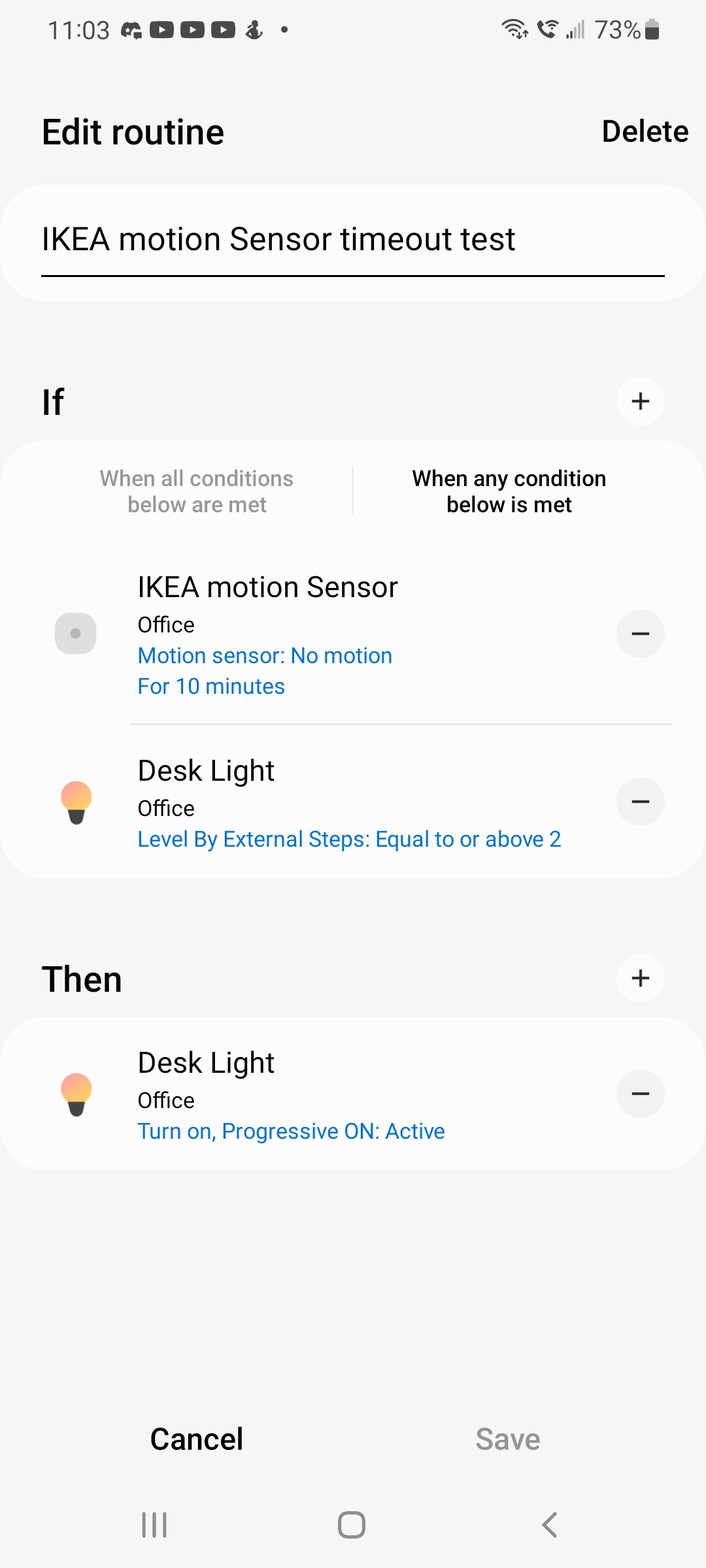

Since the latest update I noticed that a routine were no longer working.
When I checked the routine I noticed that the time for the motion sensor was gone. I attempted to recreate the routine but when I saved it and rechecked, the for 10 mins was gone again.
I can create seperate routines If for no motion for x time and for switch toggled that work but I can no longer use both in the same routine. This was previously working. Any thoughts or suggestions?

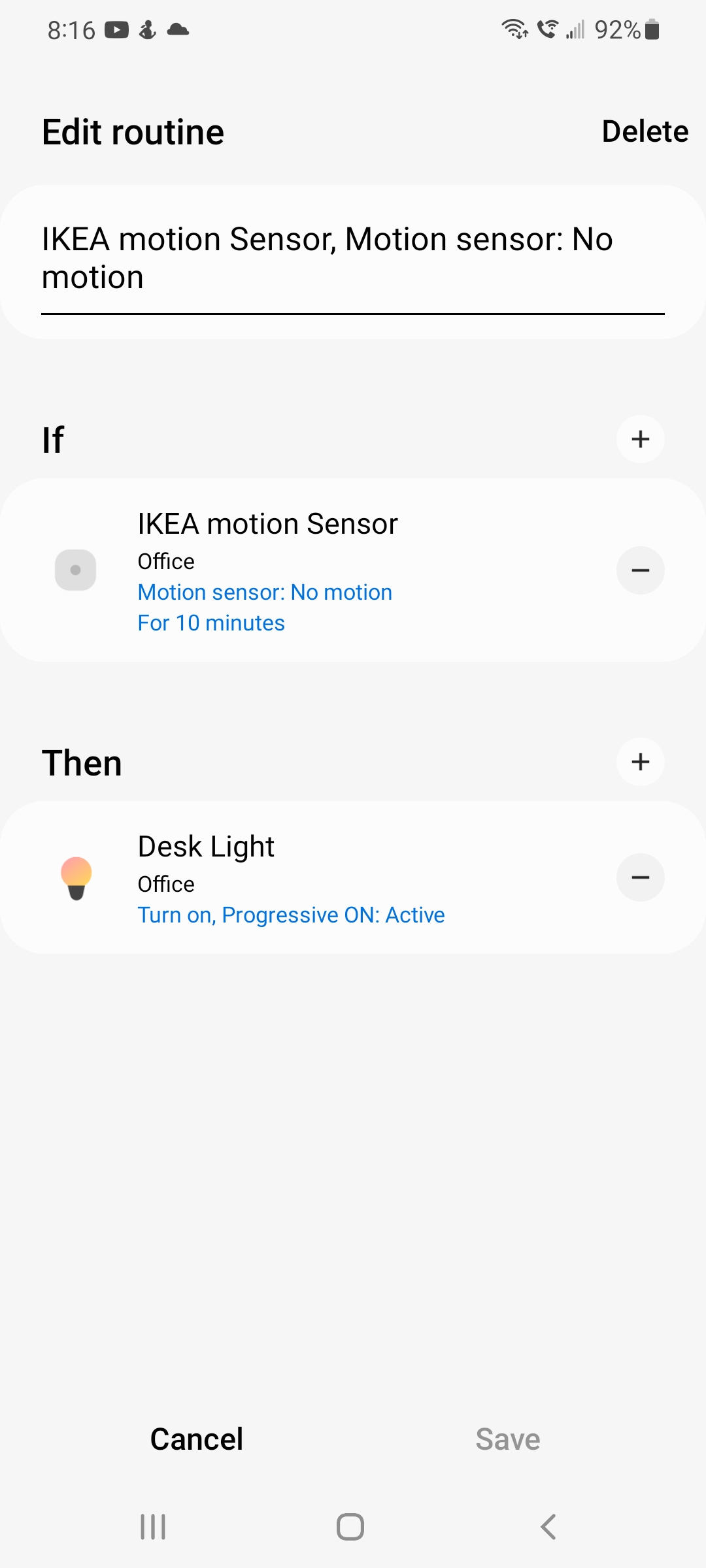

Routine Screenshots

Best i could do to replicate
I’ve done some more testing. Using any Zooz switch and any motion sensor, the routine can be created and saved with a motion delay when using the switch On/Off command but not if using the toggled up/down commands.
