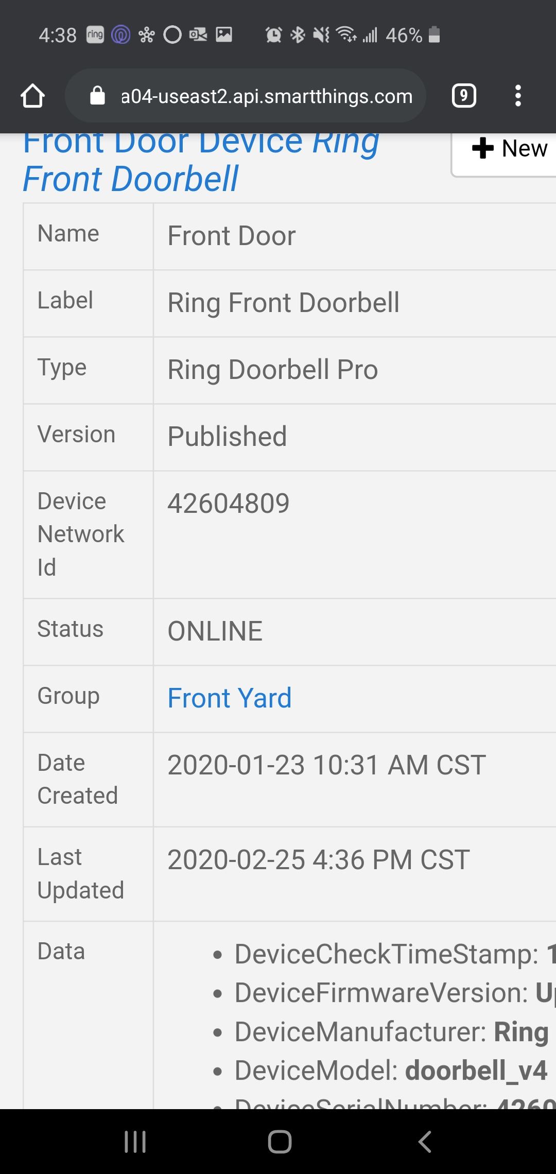

You can switch to Regular Doorbell now and also have battery reporting. With Pro there is no battery as is hardwired only, and you’ll still have button pressed trigger
This is how doorbell 2 looks with Pro, no battery reporting
Oddly enough, I have my Doorbell 2 set as a Pro and can see battery level when looking in the event list within the IDE.
