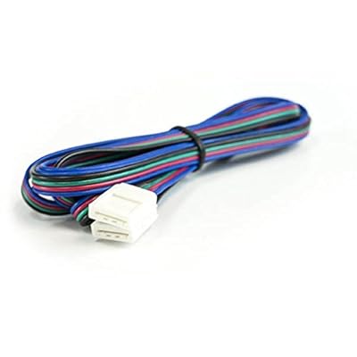

Thanks for the tip on the power supply. Where would I need to solder? The extension (second link above) is solderless.
Also, what power supply would I need to upgrade to? I’m powering about 12 feet of LED.
The extension is four wire RGB, not RGBW five wires. The five wire strips are too small for connecting without solder.

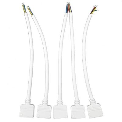

I’ve seen some listed like this:
However, I can’t imagine they would work and reviews indicate that. And I believe the Supernight LEDs are 10mm anyway.

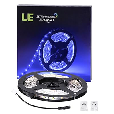

Also, I was thinking about just using blue rope light. I’m not sure I need al the colors. Just really wanted to play with multi-color since I’m sure I’ll use it somewhere around the house in the future!
If I were to do a single color strip, such as the one below, could I still dim it? Does a dimmer work with the transformer or does the transformer just crap out with lower input power?
