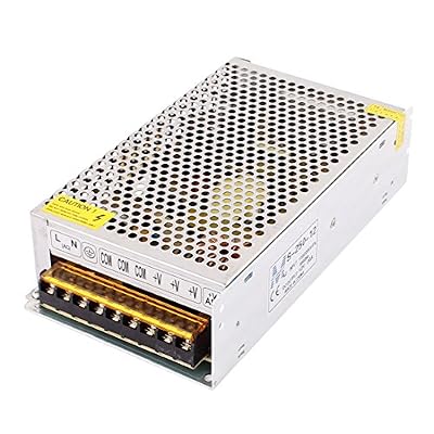

I am totally lost how to proceed, i know that i need a power supply and strips.
Could anyone link me what kind of power supply and strips to use.
Its for kitchen cabinet < 10m of strips
I was thinking of using it with smarthings and google home (no phys switch needed)

@Manxman27 from the power supply and the fibaro, what kind of cable do u use? the power supply does not come with any cable i think
I used some kettle leads I had spare. Same cables you use for a computer or monitor. I cut the kettle plug off and wired it to the power supply.
