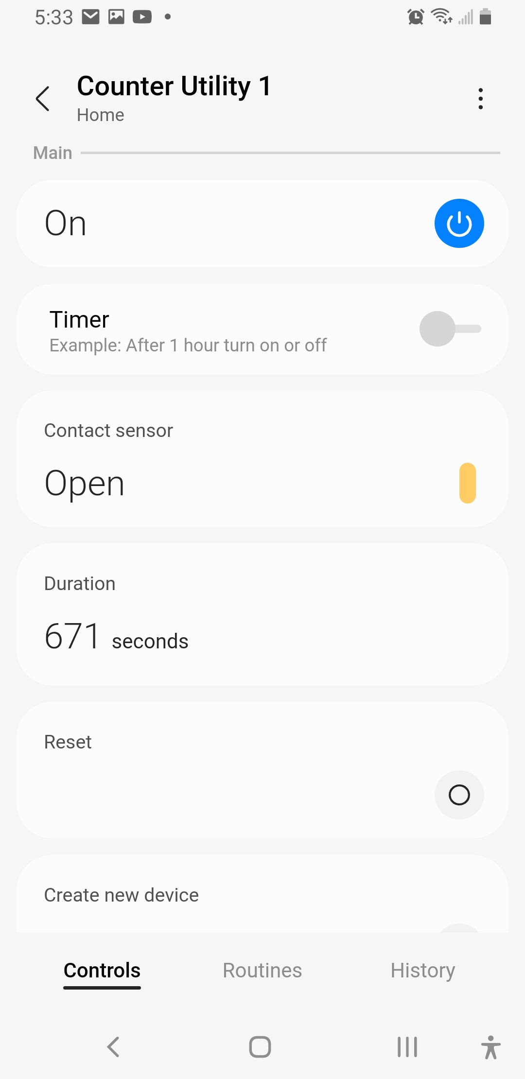

When you open the device you’ll see that it provides both functions you were looking for: a duration for how long the switch is on (Main component), and a counter for how many times the momentary button is pressed (Counter component). There are also reset buttons in both components, and a button to create additional devices.

On the device Controls screen, turning on the switch will update the contact sensor state per your preferences and begin the duration tracking and auto-updating of the duration field. The duration field will show the value in the units you chose in settings (seconds, minutes, hours, etc). Turning the switch off will reset the duration to 0 and terminate the auto-updating. If you want to refresh the fields between auto updates, just perform the swipe-down action on the screen.
Tapping the reset button with the switch on causes the tracking to start over at 0.
The ‘create another device’ button does just that - if you need multiple of these devices. Each will need to be uniquely configured in settings.
In the Counter component, each time you tap the momentary button, the counter simply increments by 1. Tapping reset will set it back to 0.
