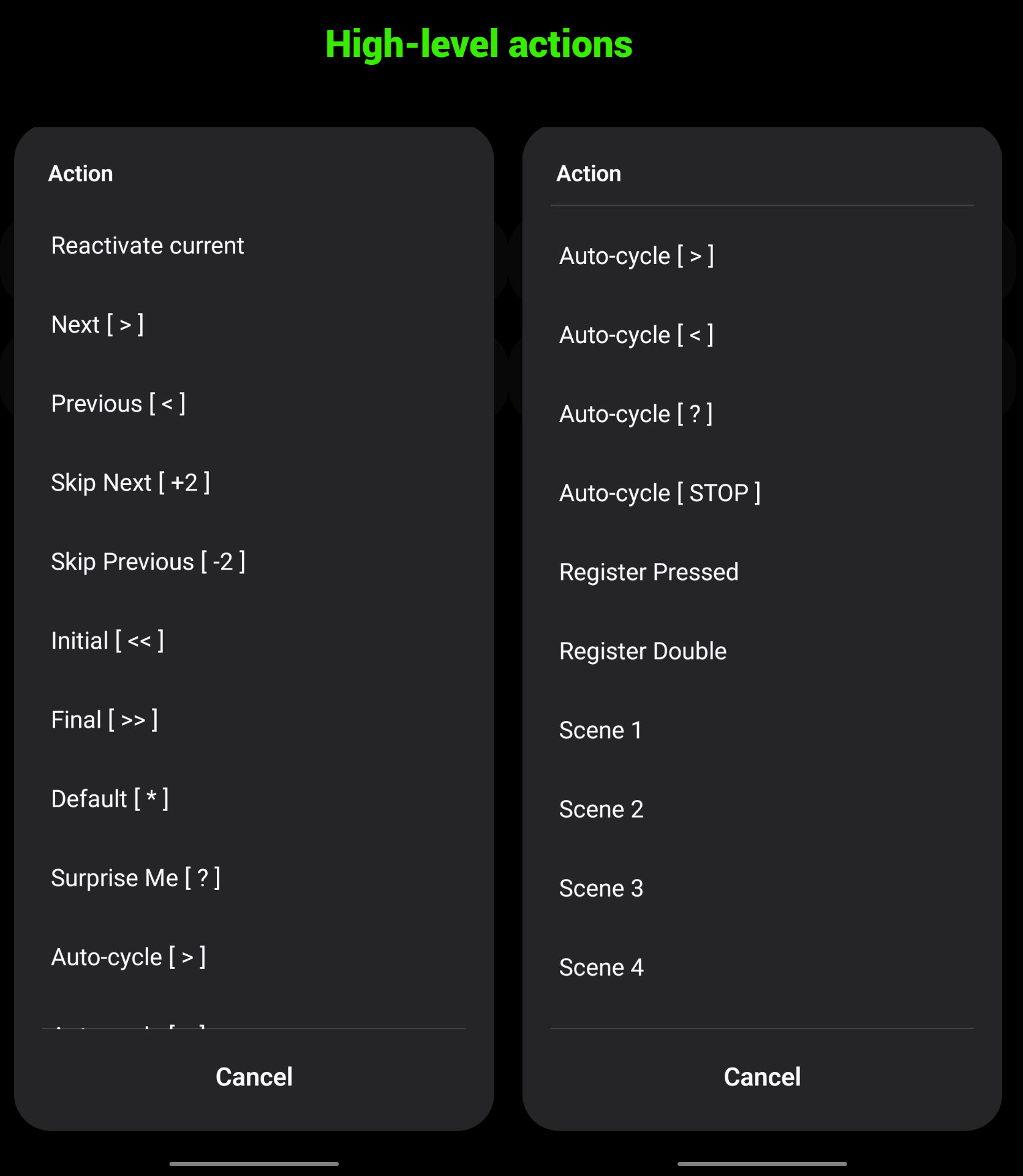

  3. Assign actions to the buttons. The Switcher device is not short on commands, in your button pick “Next” as action to cycle forwards and “Previous” for backwards. You can also use the dashboard button with configurable actions instead of a physical button, or the media track buttons or even link a supported rotary knob / scroll wheel.

… fight monotony with something less predictable than next/previous? Got you! Use the Surprise Me action and let the driver pick the scene for you!
… cycle scenes while holding a button? Glad you asked, auto-cycle has you covered! It is incredibly satisfying to see the scenes changing and just stop it when you like. There are settings to start / stop the cycling with buttons that don’t support hold/release.
… assign a colour to triple-tap even if your button has single-tap only? Yup! The driver has a special action called Register Pressed. If you call this action from your button, the driver understands it is a multi-tap sequence so it will wait until the sequence is over. If you press it three times it will activate scene 3. Neat, right? :grin: You can change the default waiting time for the next tap to fit your button behaviour. Supports buttons with native double-tap! Try 1 second delay and don’t forget to also assign the action Register Double to the double pressed event. You can have up to 1000x multi-tap :sweat_smile:.

Then in the buttons add the actions like Next or Previous.
Where is this? (Which screen in the app?)

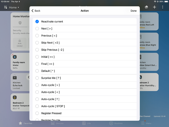

The button actions? You can either go to the button view and assign any of the actions there like Pressed or create a routine from the routine screen.
In that case, the If action would be: device status, button, Pressed. And the Then action, control devices, scene switcher, actions, Next.

When you choose the scene switcher virtual device for the then, you will now get a whole bunch of different possible actions that can cycle through the scenes you created for the scene switcher virtual device in step 2.
End result: your physical button presses on your existing buttons can now do a lot more by triggering various scene switcher virtual device actions.

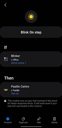

Tutorial: How to build a Blinker or Flasher
Blink any light all the number of times you want with sub-second delay with only 4 simple routines or even 3 if the final state is predetermined.
Follow instructions in first post to install the driver and create the first Switcher if you haven’t already.
The switcher settings:
  • Set Number of scenes to 2. Only need On and Off for blink.
  • In the Auto-cycle settings, select Starting scene “< Scene 1 / Scene 2 >”. This will allow us to start the blinker from on or from off, depending on the previous state of the light.
  • Circular behaviour if not stopped: “Ends right before starting scene”. This will make sure the blinker finishes in the correct state, which is the opposite of the starting one.
  • Circular max loops is the number of blinks, pick 3 for instance.
The routines:
  • Create two routines to assign scene 1 to the On action and scene 2 to the Off action. Will look like this.
  • Now, if you want the light to finish in the current state, you’ll need two routines with the precondition being the state of the light and the trigger a button / sensor / virtual switch / whatever. One to call Auto-cycle [>] if the light is on (so it starts with off), and another to call Auto-cycle [<] if the light is off (so it starts with on).
