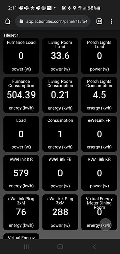

I just tried to add this devices to Action Tiles, and they work and are providing live update. Now I just have to spend some time to arrange all tiles the way I want.

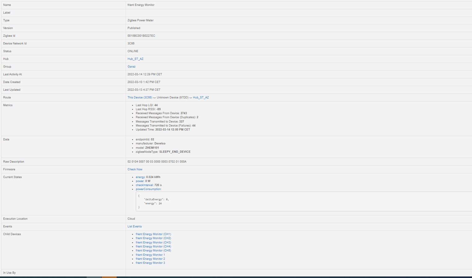

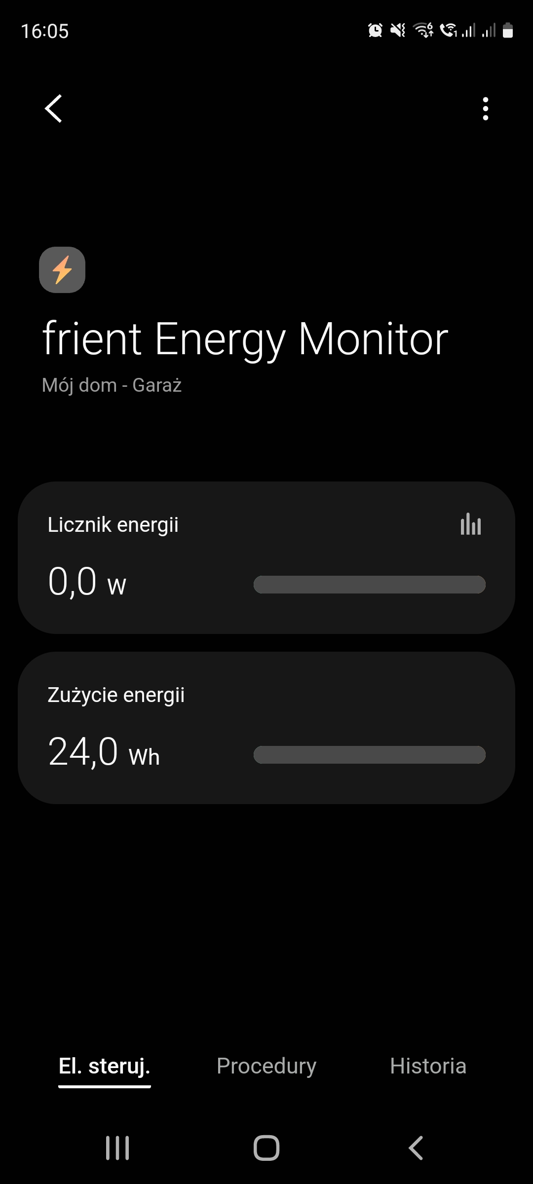

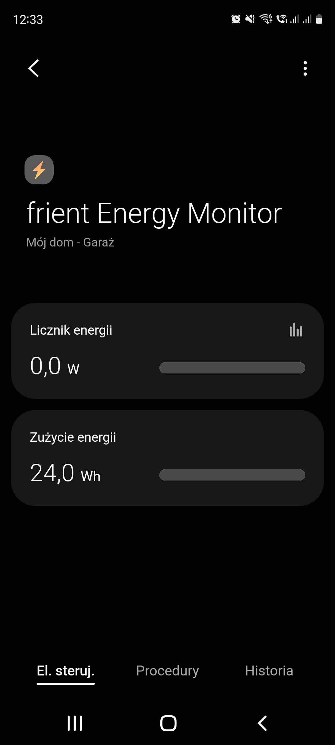

Hello,
this is how it looks for me at the moment, I must have checked all the drivers available in the HUB.
Please tell me what else you need and where can I find it as I am a very new user of Smartthings.
Thanks for the help.
Greetings.
Your device only measures power and energy.
With the DTH Zigbee Power Meter it will work well with your device.
This device is not included in the smartthings stock DTH and therefore smartthings has only included the “E240-KR080Z0-HA” model in its Beta edge driver that will replace that DTH in the future.
If Frient advertises on Amazon that the device works with Smartthing, you should contact Frient support to find out if they have a specific DTH or Edge driver for the future use.
