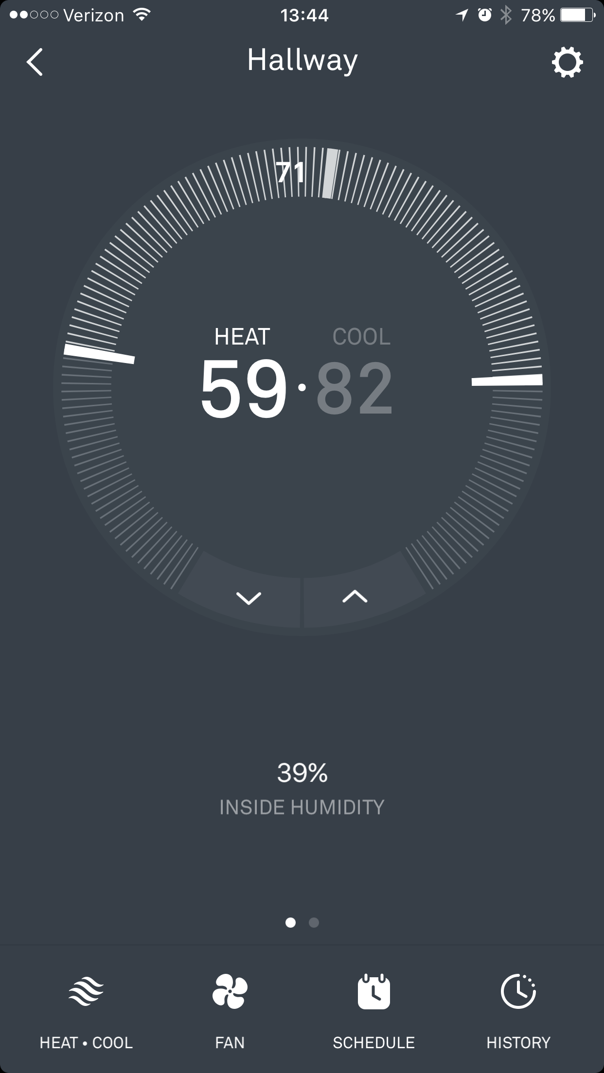

What mode should it have been in? Do you have any rules or routines that a making changes?
No rules routines or anything that I’m aware of it should have been in HEAT mode.
The outside temp was in the 20 degree Fahrenheit range and it got down to 59 indoors haven’t seen this before and I’ve had the nest for about 3 years or so
