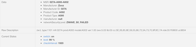

@iderdik - If you go in the IDE and select the switch under My Devices, do you get this (note “numberOfButtons: 2”). If that is set to 0, the scene control is not turned on.
Otherwise, here are screen shots through the process.

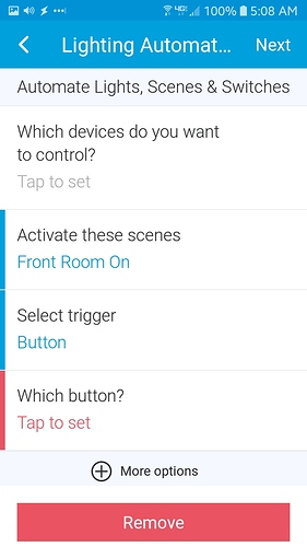

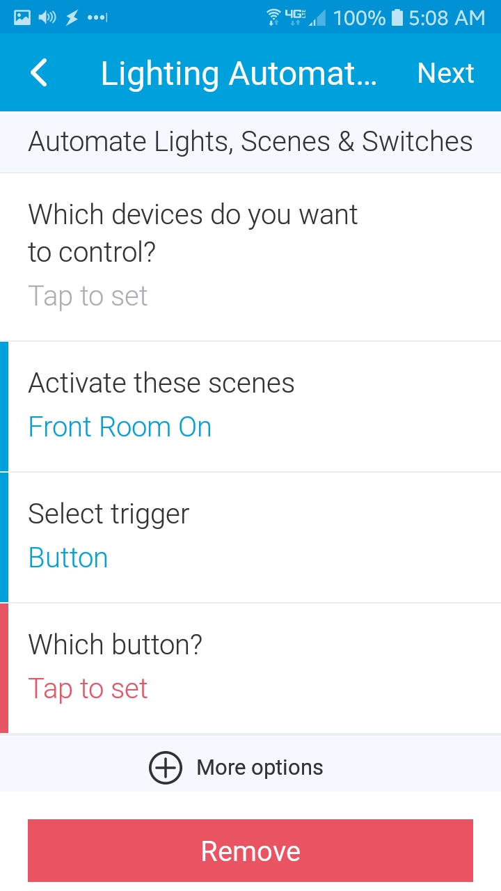

After you setup what you want to control, tap on “Select Trigger”.

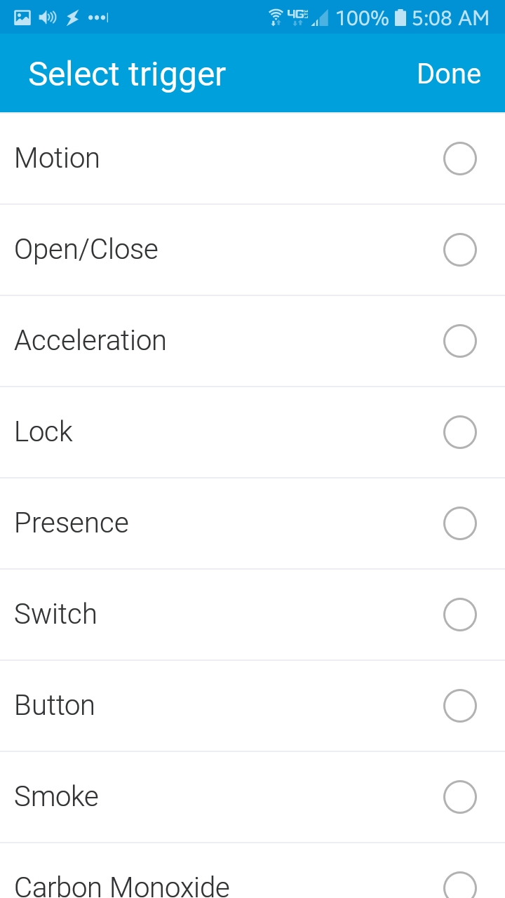

You’ll see a list of possible triggers and you need to tap on Button

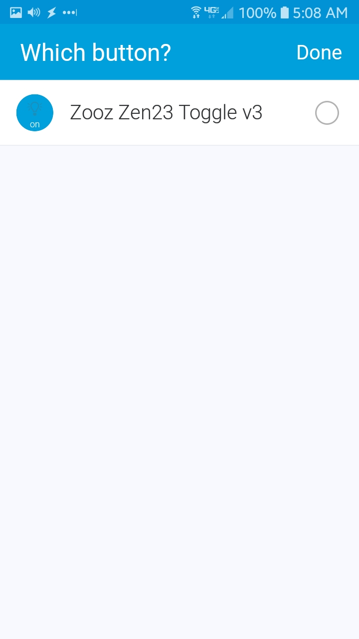

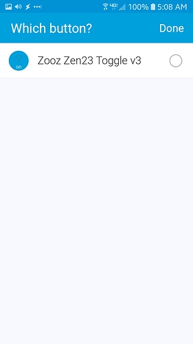

Next it will ask you which button, so tap on that
Now the switch will show up (this is a Zen23, but it’s the exact same for a Zen24)

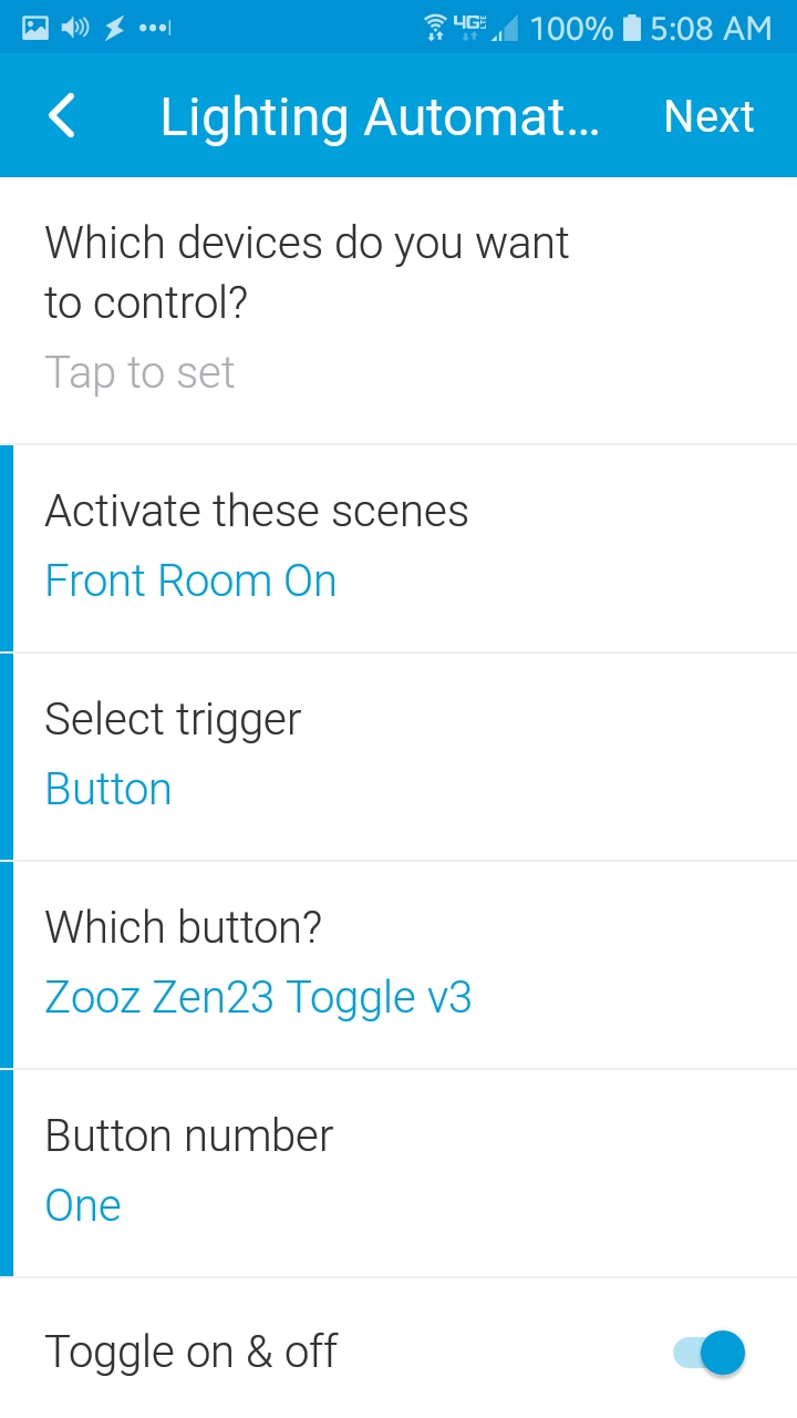

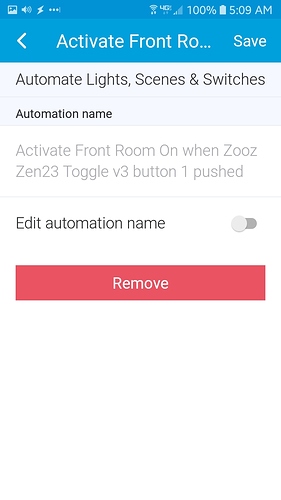

As soon as you select the switch you should see something that looks like this

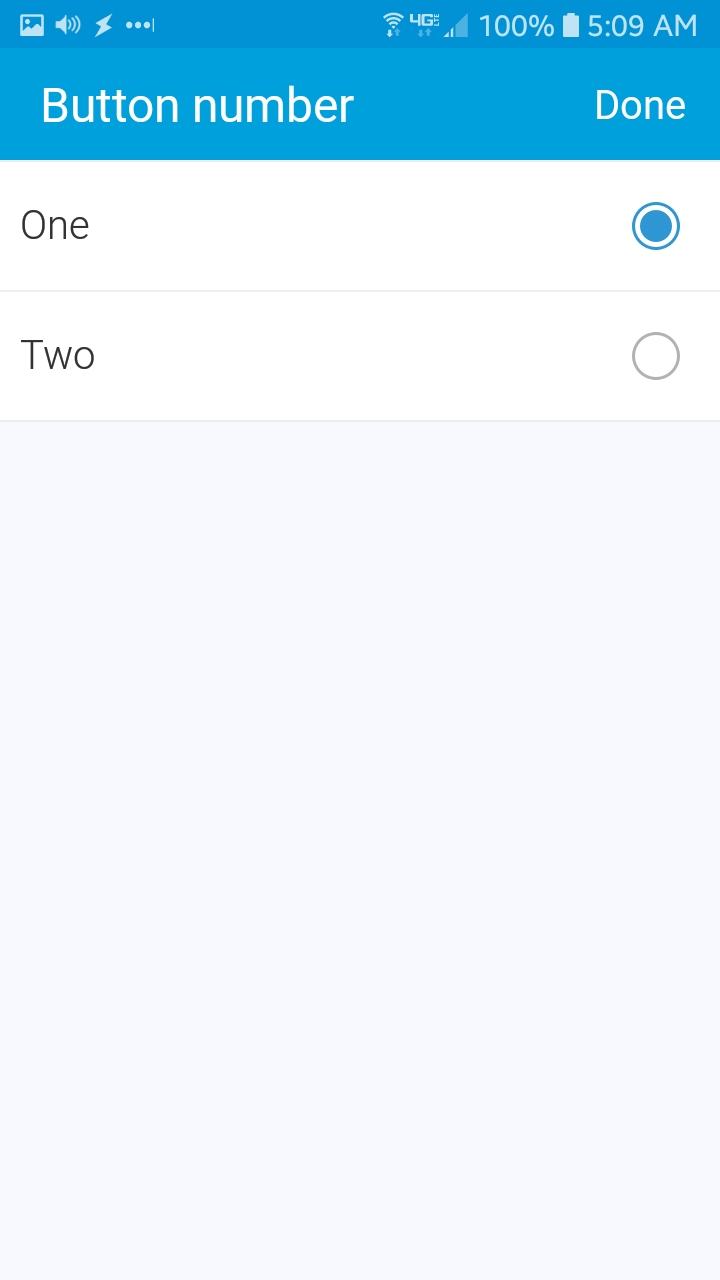

If you tap on Button Number, you can change the button that you use for this assignment
If you don’t see “Save” in the upper right (can be a problem if using android), my recommendation is to clear cache, clear data, uninstall, and reinstall the smartthings classic app.

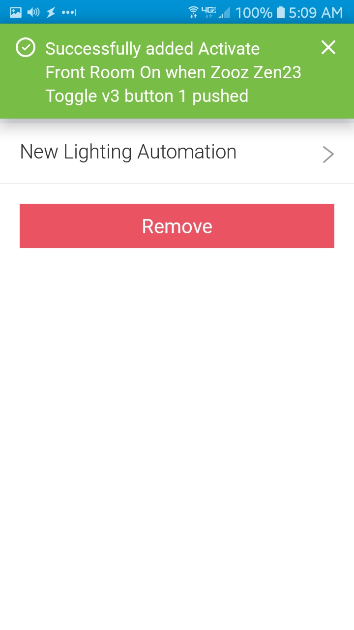

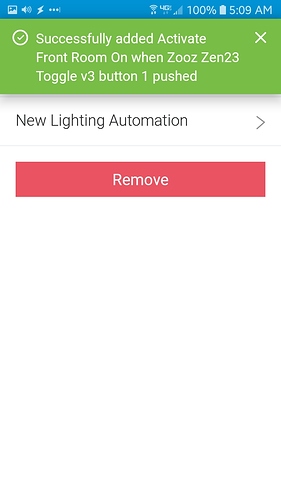

But when you save, you should get this green bar and then it should end up taking you back to the smartapp screen.

@iderdik - Just to be clear the “3.0” is not the version of the software, it’s the version of the switch itself. If you look at the “Raw Description” in the shot I posted at the top of my writeup, you’ll see over to the right “ver:3.00”. That’s the firmware on the switch itself. Unless you bought the switch very recently (like last couple of weeks), you won’t have the version that will work with this handler. If you do have that version, please let me know.

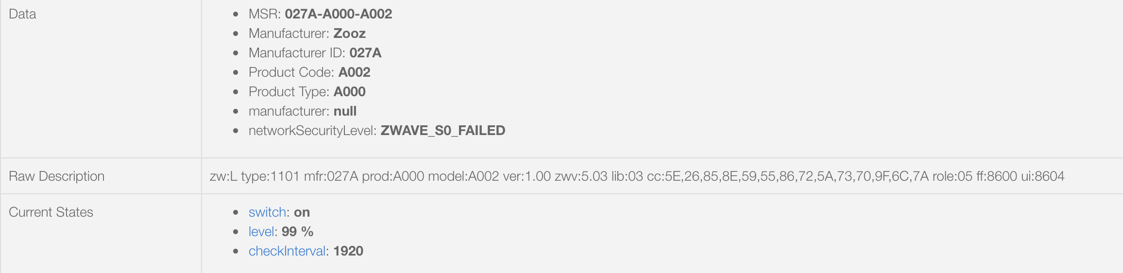

I bought my Zen 27 on March 11th so its a little more than a month old. The device page looks like this:
The new Zen27 will be getting released in the next few weeks I believe. The one you have won’t support scene control. You might want to contact @TheSmartestHouse about it.
The release of ZEN27 2.0 is scheduled within a week or so. @iderdik if you’d like to upgrade your switches to the latest firmware, just get in touch with Zooz support (remember to include your order number in the inquiry).
