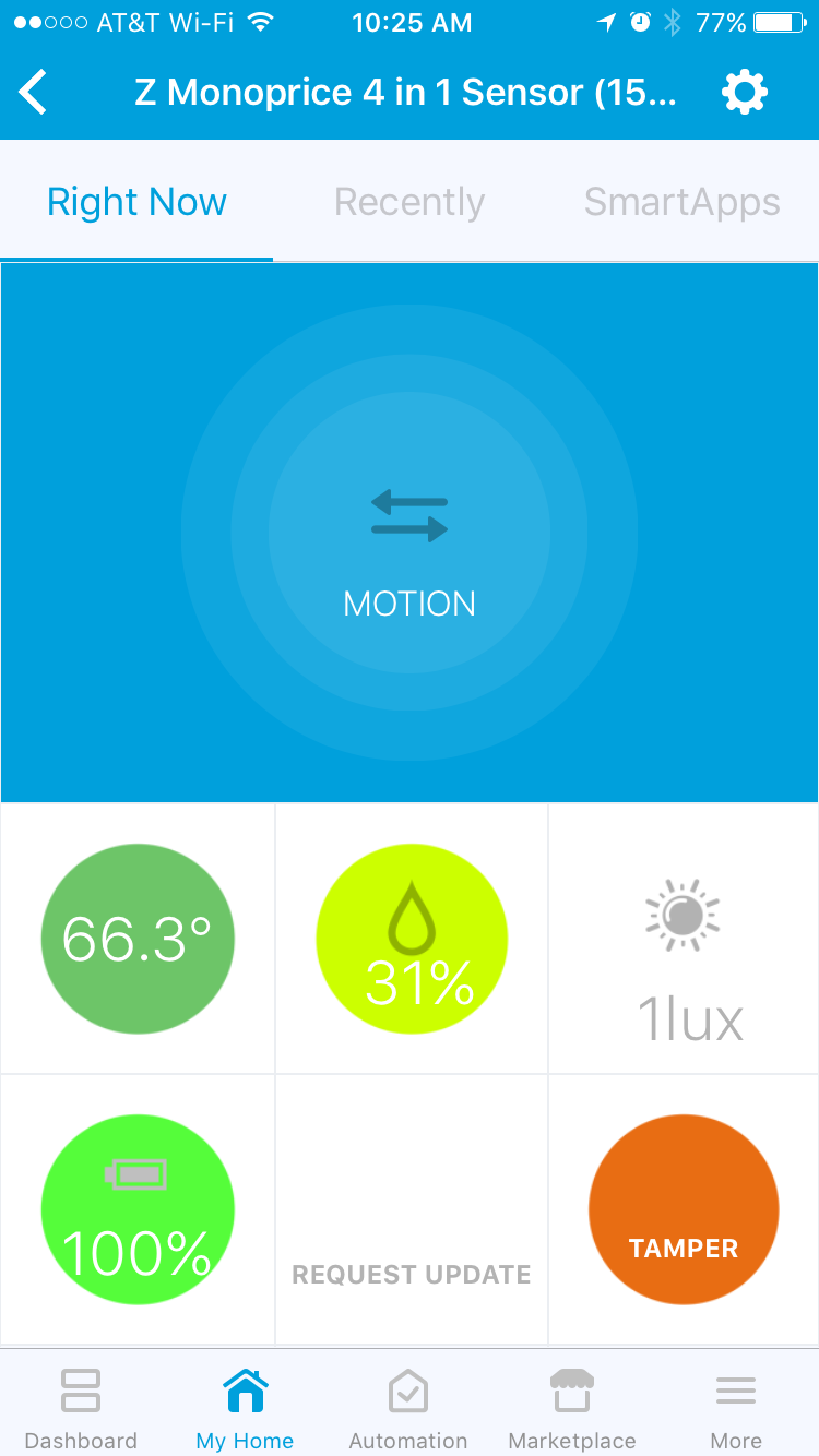

Official Monoprice 4 in 1 Motion Sensor with Temperature, Humidity, Light, Battery and Tamper Notifications Device Handler - Version 01.00.03
  • Updated layout to show all sensors on a single page for most phones
  • Temperature correction values can now be entered as a decimal (+ve or -ve)
Thanks for the update, but did you remove the Tamper?
It’s all on a single screen now.
If don’t see it, try to open/close the device again, maybe your sensor is too far from the nearest repeater and the event is getting lost in the mesh.
Not on IOS.
See above, that’s an iOS screenshot.
OK, yes it works sorry, when open. I thought the word tamper was always visible, and the color changed when tamper happens. I guessed wrong. Thanks.
