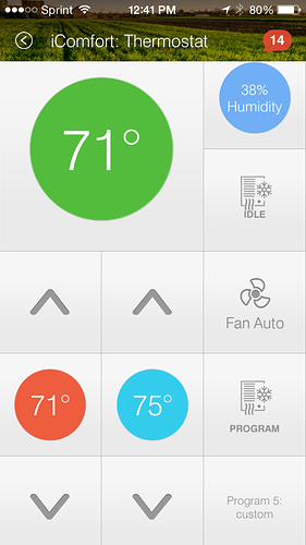

Correct in the “my device” that is what I am showing, still a new users or I would upload screen caps as well. On the app side the green circle that you have (its dark blue for me) has “–” and the high/low temp have “–” as well. The mode, status, program state are working as though. Could this be because I am running mine in Manual mode vs Program mode? For a phone I have a Nexus 4 running Cyanogenmod 11 (Android 4.4.4). I can check my wifes phone when I get home, she has a Nexus 4 as well but running Stock Lollipop.
Manual mode would show like this:
I think you may have some issue with your app on Android. Could you contact support@smartthings.com to verify? I have only tested this in an iPhone so far. I would expect this to work similarly across all platform like Android’s.
@copyninja I am having the same problem as @jsievert . I am using a Nexus 5 running Lollipop 5.0.2. You suggest contacting Smartthings about their app, but what exactly should we be getting them to verify?

I really appriciate your work on this, this is the reason i switched from vera to smartthinga, but when i added the codes, i can use it to control my icomfort completely but when i use my android app, except the humidity everthing else is empty and i can not do anthing. Is there anything that might help me to use it on my android phone?
still looking into it. iPhone and Windows Phone worked fine. I don’t own an Android phone so it’s a bit hard for me to test
I really appreciate your work, and I would like to help you on that, let me know if I can do anything, like sending you screenshots or logfiles if any. or anything that can help you on this.
By the way I believe it is just the interface glitch for interface, because when I click on activity feed button in the android app, it will shows all the actions that has been done, like temperature change that I do from the thermostat or iphone app.
