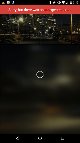

After the recent update for android app, it causes the app to crash, when I select the Things it shows a red ribbon and returning error instead of the devices.
I’ve just added Away Mode button in the new version. If you intend to install this new version, please uninstall the previous version first, remove it from SmartApp section and SmartDevice section. I think I may have a solution for Android errors. Just a fair warning to all, I didn’t have time to fully test this version and also, I don’t own any Android devices at all.

Looks like it is working on Android now. Although I did have to roll back my app to 1.6.9 as the 1.7.2 update flat lines on my phone. Thanks for the work on this!
Unfortunately still does not work on my device, which is a Nexus 5 with lollipop 5.1, Jason I may have change to find an android unit for you, but first I wanted to see if you have used the Android simulators on PC? Which is much easier to deal with other than a real device which there are hundreds of varieties out there.
I used blue stacks to simulate android. It was painfully slow. Seems like it worked for @leonard_v_fisher. Did you install the right one? I had to maintain a different code for android. Check my previous post
