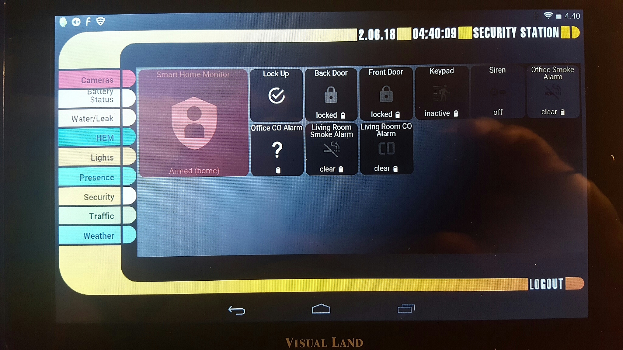

So I have mine all finished using Fully Kiosk Browser and I must say it’s friggin AWESOME !
I haven’t been this stoked in years — ya doesn’t say much but hey I’m retired.
I made a few tweaks but the one I love a lot is in the title bar section where LCARS or whatever menu link you are on. I tweaked mine to add STATION to that title so Security shows as SECURITY STATION or TRAFFIC STATION and so on.
If anyone wants to learn how to do that look at https://www.w3schools.com/cssref/sel_after.asp
Fully Kiosk Browser is at http://www.ozerov.de/fully-kiosk-browser/ if you don’t have it and it’s only for Android Tablets.
Oh and it’s running off my Raspberry PI 3 – Raspbian GNU/Linux 9 (stretch)
Nice setup!
I’m pretty happy with it… thanks for sharing this. Now I need to get Picard saying “Make it so” !!!
That looks great! How did the documentation work out for you? Any issues or questions during the process?
