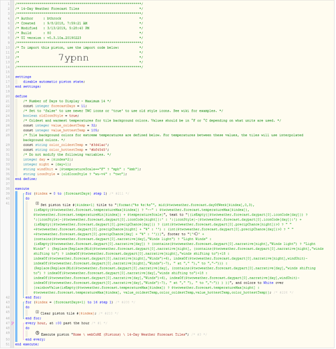

Please offer me a little guidance here! I would include screenshots up I am not sure what you want to look at, the pistons are just copied from the bin backups so its not a problem with me setting them up. I have made sure that the local variables are set correctly, and as I said they do run on their, I just can’t see the tiles it is suppose to make.
