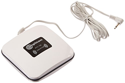

Another alerting device is a bed shaker. This is just a 12 V version of the vibrating thing in smart phones. You can buy 12 volt bed shakers that plug-in with RCA connectors. All that is needed is an outlet that plugs into the wall, interfaces with smart stuff, and provides a 12 volt triggered output. I haven’t seen these available.

For the bed shaker, I believe most of these are designed to plug into an alarm clock. So the question then is there one of these alarm clocks which can be set to go off as soon as it receives power. That is, if you unplug it while the alarm is going off, and then you plug it back in, will the alarm still be going off?
If so, that’s easy. You just plug the alarm clock into a “pocket socket” (removable wall plug) and then you control the alarm clock going on and off with your network.
If none of the alarm clocks have a persistent alarm when power is restored, though, then you may have to look at altering the power plug on the bed shaker so it can draw current directly from a wallplug. This might require step down adapter.

For the bed shaker, yes something like the wall plug outlet with a 12 V transformer and standard 12 V connector that can be triggered to output a square wave. A fan is a good idea, but I could probably sleep through a tornado :grinning:

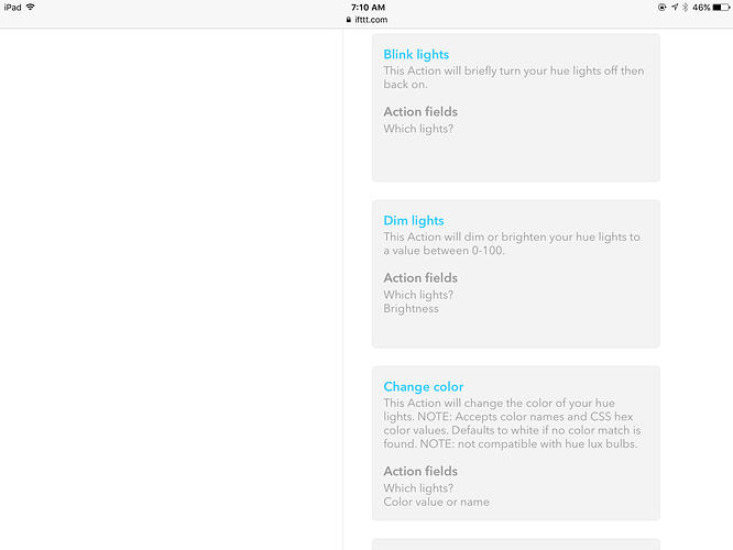

If you just want to give a notification, many people, myself included, just have a light change color. You can do that using the free IFTTT service) although lag varies from house to house), with Tasker on an android phone, or by using core.
If you have either Phillips hue lights or LIFX lights, both have their own IFTTT channels, so that’s probably the easiest method. At my house the lag is a pretty regular eight seconds, which works for some situations, but is a little long for others. But other people have much longer lag so you do need to investigate that.

There are a number of bed shaker alarms available, including some with smoke alarms or acoustic sensors to register when the regular smoke alarm goes off. As their own product guidelines say, though, I wouldn’t trust my life to SmartThings.

I’m deaf, just like you! I’m very fascinated with all of this and I’ve also been working on similar things like this. All of the bed shakers/vibrators don’t plug into a conventional wall outlet. They go into slot on the clock. I don’t understand how you put it in a wall outlet power adapter? Do you have a link to something to do that? I could easily use a Wemo plug and IFTTT to trigger it at night if sleeping.

A bed shaker is really just a 12 Volt version of a vibrator, like the one in a cell phone. To turn a bed shaker on you only need to power it with a 12 Volt power supply.
I combined an Aeotec extension cord-like (I think these have been discontinued) wall outlet, a “Wall Wart” AC plug-in 12 volt power supply, a short adapter to convert the power supply connector to the type of connector needed by the bed shaker, and a SonicAlert Super Shaker. I found everything on eBay.
The Aeotec plugs into the wall AC and would be on/off controlled by SmartThings. The 12 V power supply plugs in to the Aeotec device. The Super Shaker plugs into the 12 V power supply using the conversion connector.

That conversion connector to connect the super shaker to the plug is where I’m hung up. Been looking on amazon, but its hard to find the right one. I might just have to buy several and see which ones fit. Unless you can link me directly to the product on ebay or amazon?
