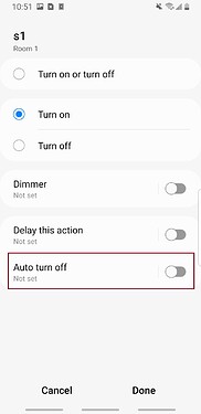

If so, these are already allowed to run locally. Are you having trouble running locally your routines using those options? If so, please share a screen capture of your configuration to see if there’s something else that could be causing the “Cloud” execution.
Note: Remember that only Edge-based or Groovy-based devices (with the flag runLocal:True) should be part of the Routine to be executed locally.
