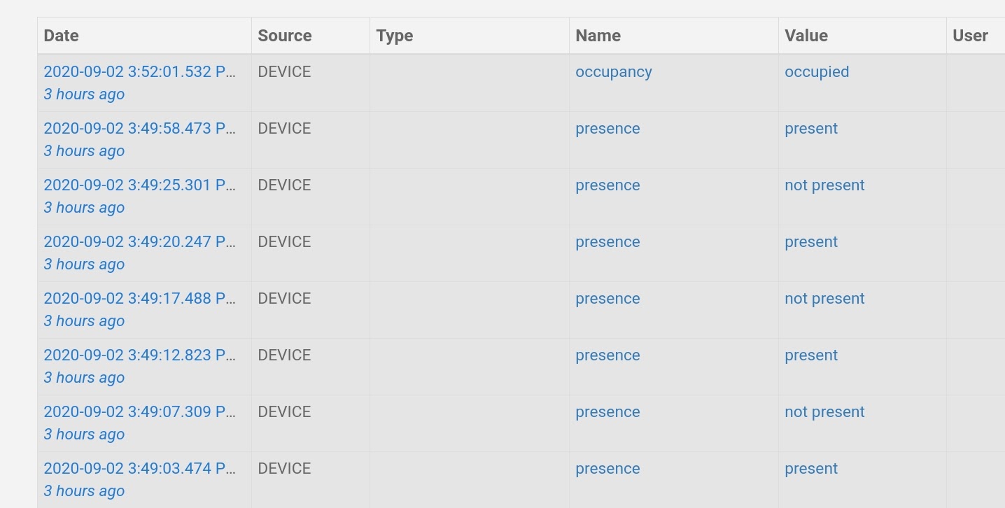

Yay, so this is how the platform handles new mobile presence devices @blake.arnold? 8 events when being well within my geofence?

Have you completed migration yet and/or turned off presence in Classic? Having presence on in both apps at the same time really messes with things and you’ll get this kind of behavior.
A long, long, long time ago. This all started when I moved to the latest release of the new app. Prior that my mobile presence devices were rock solid. Now, not so much.
