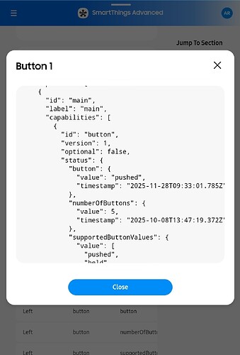

You could paste the Raw JSON of the device here for those interested.

ffs Presence Sensor
  "deviceId": "e7c6f65a-4f8b-4d11-8ac1-1bf7f1f5ef20",
  "ownerId": "57a3dbb9-6a1d-c221-d98e-ece02ed90020",
  "name": "smartthings-arrival-sensor-v1",
  "label": "Jeffs Presence Sensor",
  "deviceManufacturerCode": "SmartThings",
  "manufacturerName": "SmartThingsCommunity",
  "deviceModel": "PGC410EU",
  "presentationId": "19a84672-c706-3c40-8c2a-fbbe3cebc73b",
  "locationId": "79ad7a08-250c-47ec-947a-ab0b1b8c638b",
  "roomId": "5fa714e1-39e5-425a-b59e-9ef47b79502d",
  "components": [
      "id": "main",
      "label": "main",
      "capabilities": [
          "id": "presenceSensor",
          "version": 1,
          "optional": false,
          "status": {
            "presence": {
              "value": "not present",
              "timestamp": "2025-11-29T10:23:06.459Z"
          "id": "tone",
          "version": 1,
          "optional": false,
          "status": {}
          "id": "battery",
          "version": 1,
          "optional": false,
          "status": {
            "quantity": {
              "value": null
            "battery": {
              "value": 75,
              "unit": "%",
              "timestamp": "2025-11-29T09:28:29.375Z"
            "type": {
              "value": null
          "id": "firmwareUpdate",
          "version": 1,
          "optional": false,
          "status": {
            "lastUpdateStatusReason": {
              "value": null
            "imageTransferProgress": {
              "value": null
            "availableVersion": {
              "value": null
            "lastUpdateStatus": {
              "value": null
            "supportedCommands": {
              "value": null
            "state": {
              "value": null
            "estimatedTimeRemaining": {
              "value": null
            "updateAvailable": {
              "value": null
            "currentVersion": {
              "value": null
            "lastUpdateTime": {
              "value": null
            "supportsProgressReports": {
              "value": null
          "id": "refresh",
          "version": 1,
          "optional": false,
          "status": {}
      "categories": [
          "name": "PresenceSensor",
          "categoryType": "manufacturer"
      "optional": false
  "createTime": "2025-11-28T13:06:02.070Z",
  "healthState": {
    "state": "ONLINE",
    "lastUpdatedDate": "2025-11-28T13:06:19.522Z"
  "parentDeviceId": "375659e1-d622-46ca-9551-7e3b2157d8a6",
  "profile": {
    "id": "29e38fc2-9fee-336f-843e-6fb33afeca2c"
  "zigbee": {
    "eui": "D052A80F60550005",
    "networkId": "0D78",
    "driverId": "651d4209-c60b-4789-89c6-3b4d989dbedc",
    "executingLocally": true,
    "hubId": "375659e1-d622-46ca-9551-7e3b2157d8a6",
    "provisioningState": "PROVISIONED",
    "fingerprintType": "ZIGBEE_MANUFACTURER",
    "fingerprintId": "SmartThings/Arrival/2"
  "type": "ZIGBEE",
  "vid": "19a84672-c706-3c40-8c2a-fbbe3cebc73b",
  "mnmn": "SmartThingsCommunity",
  "ocfDeviceType": "x.com.st.d.sensor.presence",
  "restrictionTier": 0,
  "allowed": [
    "w:devices",
    "w:devices:locationId",
    "w:devices:roomId",
    "d:devices",
    "x:devices",
    "r:devices:visible"
  "executionContext": "LOCAL",
  "relationships": []
