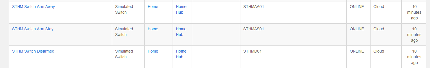

Tried changing my switches to a virtual switch. Tried editing my automations. No go. My ActionTiles screens will not update the STHM status.
If you’re looking for the workaround to fix what broke a few weeks ago, you need to change them to the “simulated switch” DTH and not use the “virtual switch” DTH. The first has state and the second is stateless, which seems to be triggering a new issue.
Can you post a screenshot of the automation you were trying to use and indicate which if any of the devices are virtual and if they are virtual, which DTHs you are using? Then we might be able to help.
Switch status will not update on ActionTiles.
