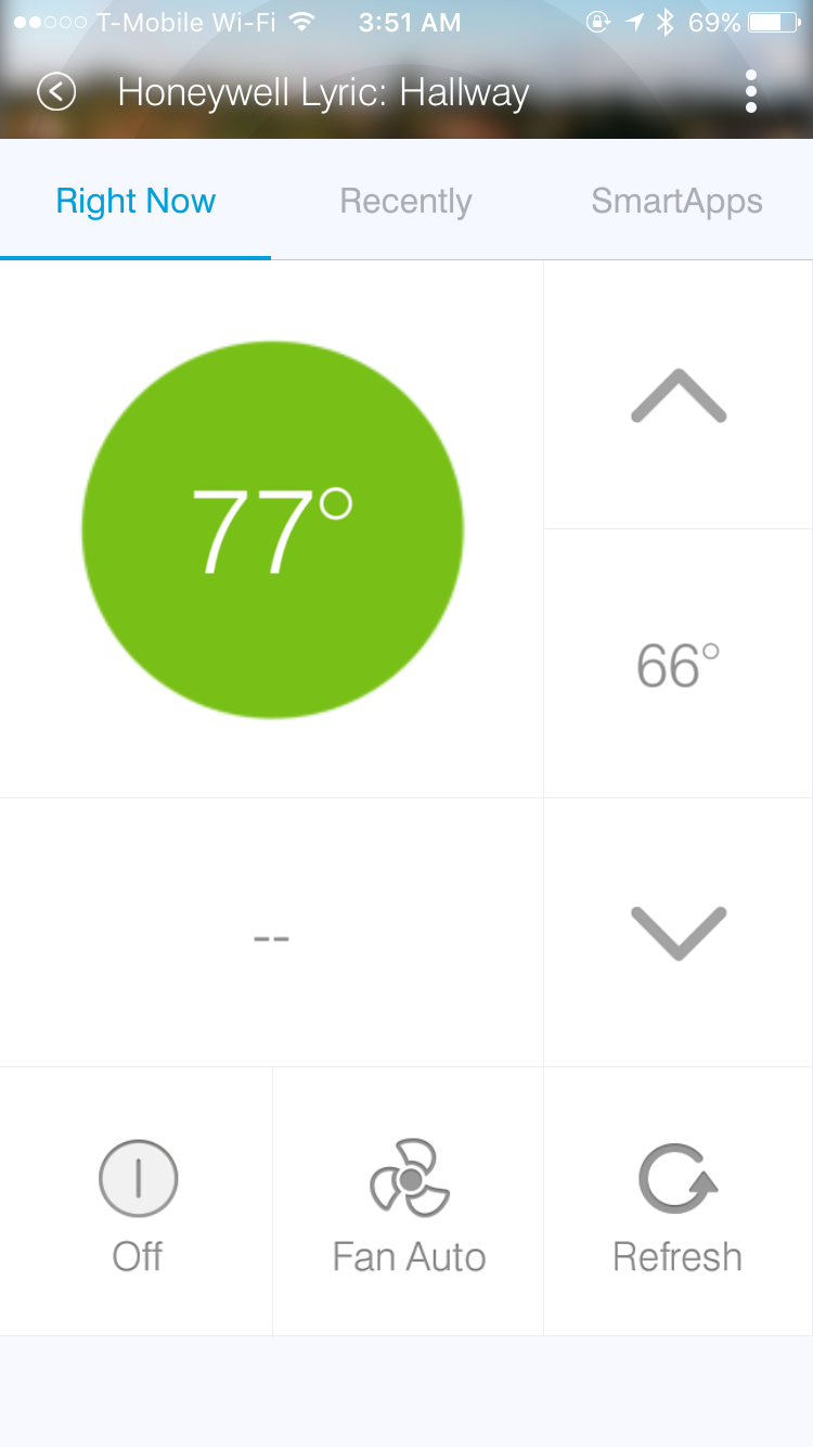

So it’s not working for me and I’m wondering if anyone has any thoughts or suggestions.
Uploading… this is what I’m getting. None of the information is filling in and j can’t actually control the lyric.
I’ve tried deleting and adding it back with no luck.
Any thoughts?
Cheers
J

Was there supposed to be an attachment there?
What are you seeing at https://graph.api.smartthings.com/ide/logs when you log in to your Honeywell account and authorize the connection?

Yes. I had attached a pic of the app but it didn’t seem to upload. I am going to try and attach it again along with a screen shot of the log.

Hi Jamie, can you control it using the Lyric app from Honeywell? It looks like the Smart App cannot poll data from your thermostat. Does it properly connect to your home 2.4 GHz WiFi network? You can try to uninstall and install the device again. If this problem still persist, can you explain the steps you take to reproduce it?

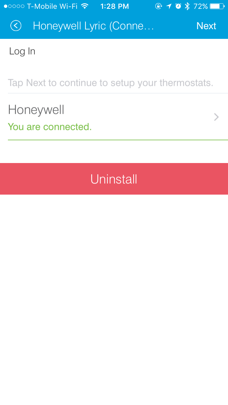

Not sure which steps you are looking for. In terms of lyrIf in smartthings…
I went to marketplace
Found the lyric
Added the device
Signed in with my lyric credentials
Clicked "allow"
Clicked next
Chose my lyric
Clicked done
Thank you for looking into it
Cheers
Jamie
