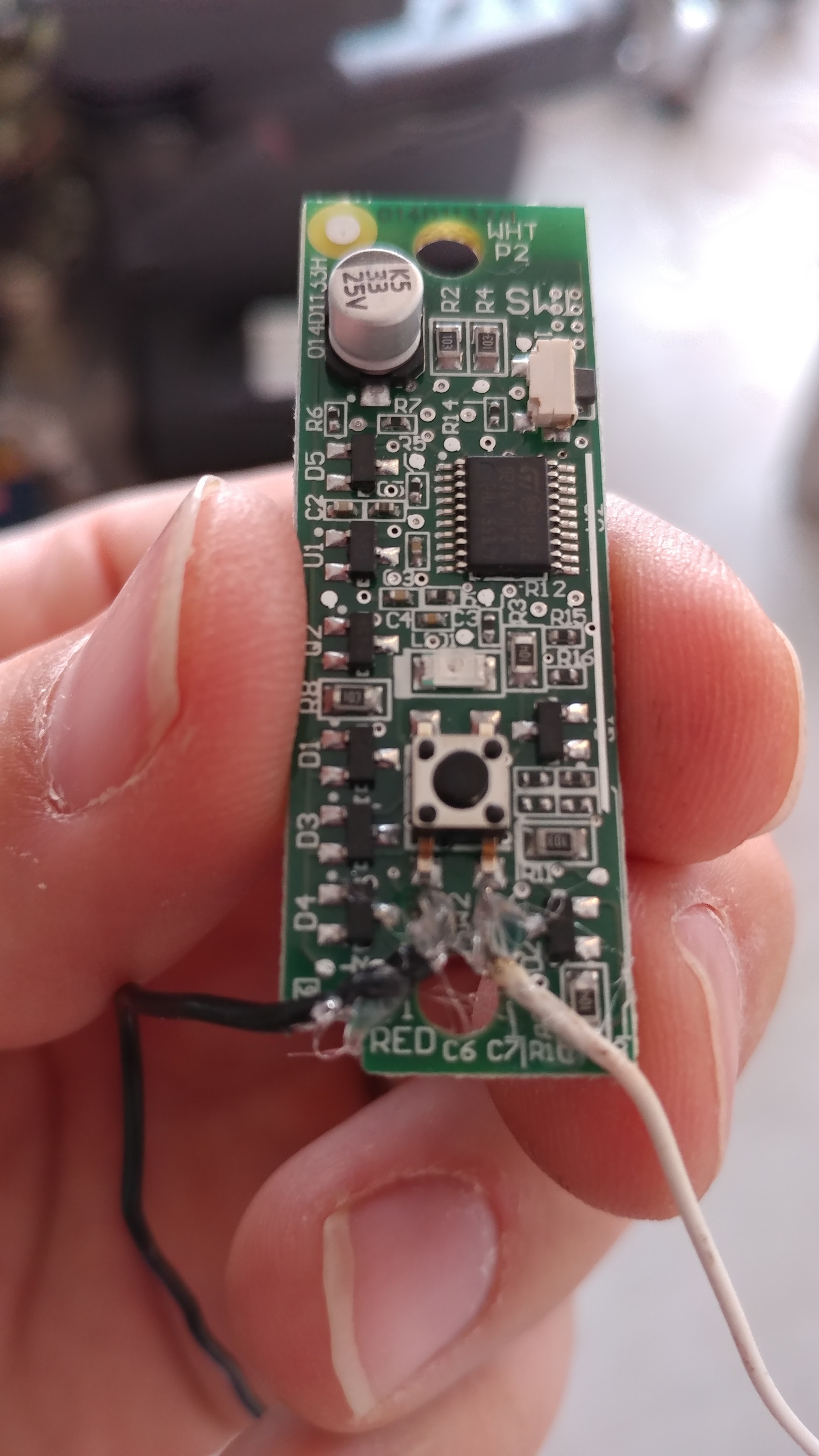

Also adding a pic of my car remote.
i attempted to solder in every option available, went with trial and error but of course 2 out of the 4 option didnt do anything (when they connected both on the same line to either white or red prongs) and 2 options did the scenario above when its one command and then kill power.

and here is the car remote i soldered as well with same scenario

Yeah, i took apart my wall panel and removed the white cap
located the 1 button and its 4 legs and then i soldered in every single option available.
when it was both bottom, it would just beep and not do anything (the gocontrol)
when crossed it would either open or close 1 time and then power dies
both upper did nothing as well
tried all 6 options … .:frowning:
