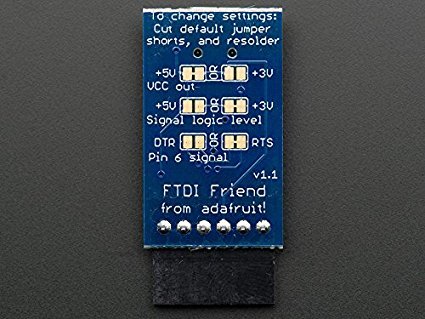

A slightly more expensive that has a genuine FTDI chip is this FTDI adapter by Adafruit.
@MABeatty1978 says to make sure you have a soldering iron to change the voltage setting default on the Adafruit FTDI from 5v to 3.3v for the H801; no easy jumper to change here unfortunately. The official FTDI drivers you can download here at http://www.ftdichip.com/Drivers/VCP.htm and use the “Available as a setup executable” link in the “comments” of the Windows section.

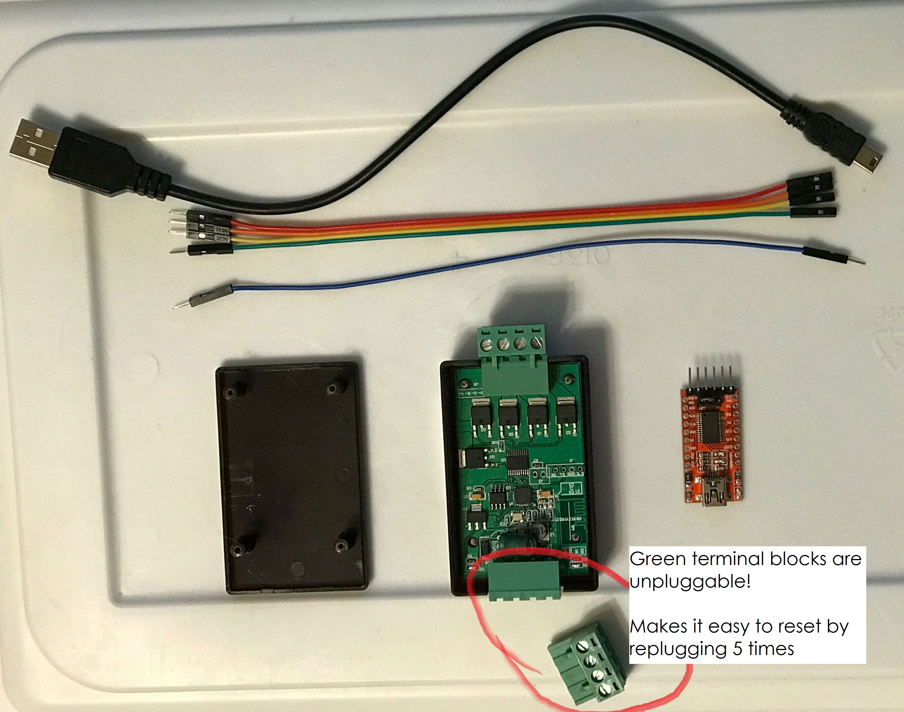

  • Here is a picture of the parts I used for flashing and how I hooked them all together. The FTDI uses the “old” style mini-USB connector not the current micro-USB that most devices have today. I still had one from years ago that I put to use.
All the wiring connected as follows
here is a picture of my setup. I have a blue jumper wire on H801 J3. FTDI pin 1 and 5 left open. FTDI jumper is set on 3.3v
H801 Rx to FTDI pin2 Rx
H801 Tx to FTDI pin3 Tx
H801 3.3v to FTDI pin4 VCC **Have FTDI power H801 to minimize communication issues!
H801 Grd to FTDI pin6 Grd
FYI, the photos are high resolution so you can zoom way in to see the connections and wiring up close.
