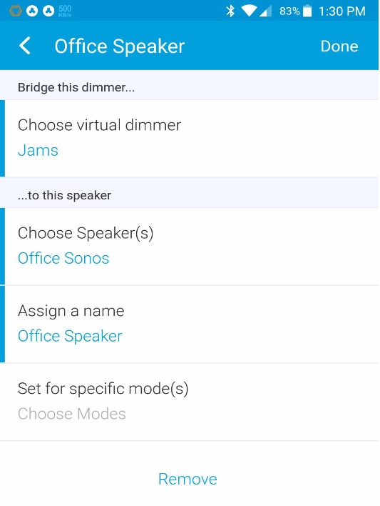

Here is my setup, Jams is the name of the Virtual Dimmer.
I switched to another speaker & I have the same result.

@Fubie Well, you’ve got me stumped here. The combination of what your log is and isn’t showing suggests the smart app isn’t installing right, which … maybe … maybe it’s a copy-paste issue? Really, the biggest clue is in the IDE log you sent, which is referring to a function that isn’t even in the code. I wish I could sit down with you side-by-side to look at what was happening in real time so we could chase this down and get it working. Do you have any interest in doing something like a Skype chat with screen share so we can go through it? If so, PM me and we can set something up.

Brief follow up on the conversation. @Fubie and I video chatted last night and looked into the problem. Turns out GROUPED Sonos speakers throw out errors in the capability.music player setlevel() command. By ungrouping the speakers, we found everything worked as intended.
