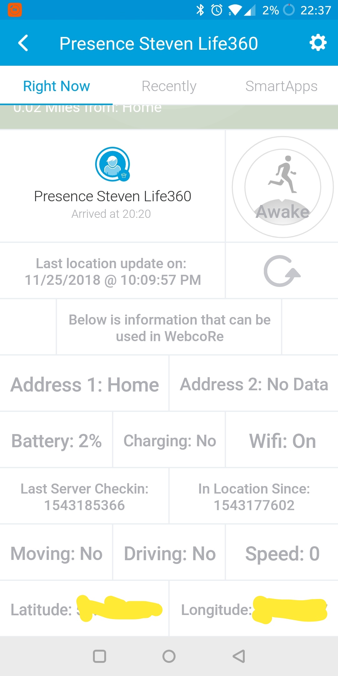

[OBSOLETE] Life360 - Refreshed Every Minute & All Places & More All API Data available for webCoRE Usage
UPDATE - November 2018
Now all useful information that Life360 provides is pulled every 5 minutes this information includes
PLEASE NOTE: The presence part of the app still runs on original code or manual refresh
  • Address1 - In the UK only seems to provide places that you have added to Life360 - US might get more information
  • Address2 - Again UK does nothing but may provide US users information
  • PrevAddress1 - Previous address1
  • PrevAddress2 - Previous address2
  • Battery - Phone Battery Percentage
  • Charging - Is Phone on Charge
  • Last Checkin - Last time the phone updated the Life360 Servers
  • Moving - Is the user moving
  • Driving - Is the user driving
  • Latitude - Latitude position
  • Longitude - Longitude position
  • Since - Time they arrive at current location
  • SpeedMetric - Current Speed in Meters Per Second
  • SpeedMiles - Current Speed in MPH
  • SpeedKm - Current Speed KPH
  • Wifi - Wifi turned on
Show%20Device
TO ADD PLACES - That will appear in address1 - If you have Life360 plus you can add as many alert places you like but on the free account only two but you can name places and I believe you can have as many as you like
This has been available for sometime in the topic about Life360 not being reliable.
But recently @btrial added some more features and I feel more people should know about it
  • distance from your chosen place (can be used in webCore),
  • sleep / awake status (can be used in webCore)
  • last location update date/time
Ideas and some code snippets taken from webCore presence sensor by @ady624 (so praise goes to him)

It was more a thing in mid 2016 when I originally made this. Some people no longer have the problem, even I no longer have but thats because we have better phones and 4G signal than we had in 2016, but it was also due to Life360 breaking the app too. Back in mid 2016 early 2017 once or twice a week life360 didn’t work correctly. This is the main thread at the time Life360 seems to send notifications properly, but presence status not updated? moaning about the problems of life360 at the time.
