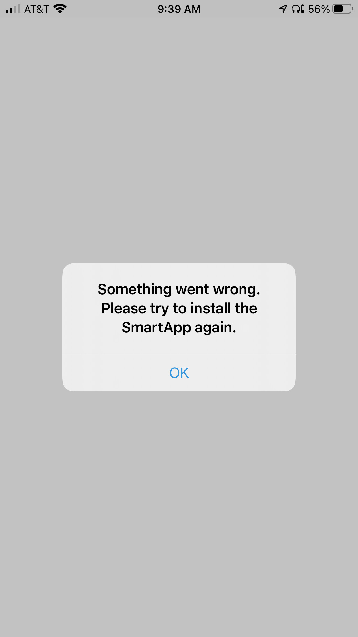

I did do the first one just now and it’s showing up as a linked service but I’m unable to add it into any automation. When I click it it gives me an error that tells me to try to reinstall it. Plz see the screenshot.
When I go to smart apps It gives me the same error.

with that image, i do not really have enough info to be able to respond. there was a brief outage earlier so not sure if it is related.

I hear you. I realize it’s cryptic but that’s all it’s giving me.
If I go look at my linked services and touch on Life360 it gives me that dialog in the screenshot.
If I go to Smart apps, scroll down to Life360 to try to add it, and touch on it, it gives me that same screen.
That’s all I can tell you. Sorry. I wish I had more information because then I might be able to figure it out too LOL

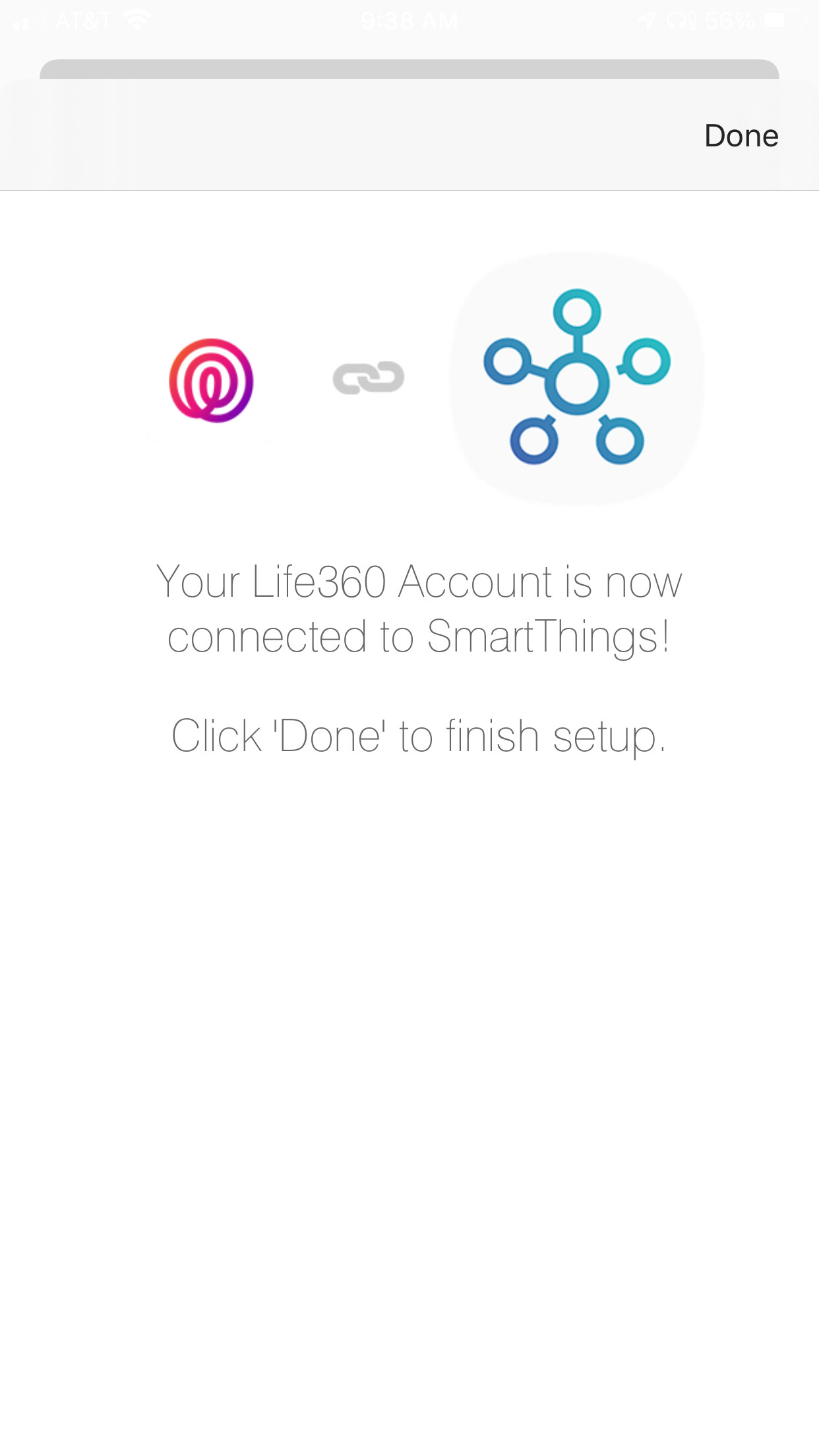

Aha. I have zero idea what this means BUT I enabled OATH. Saw someone talking about it on the second idea link and thought I should try doing it on the first one. Works!

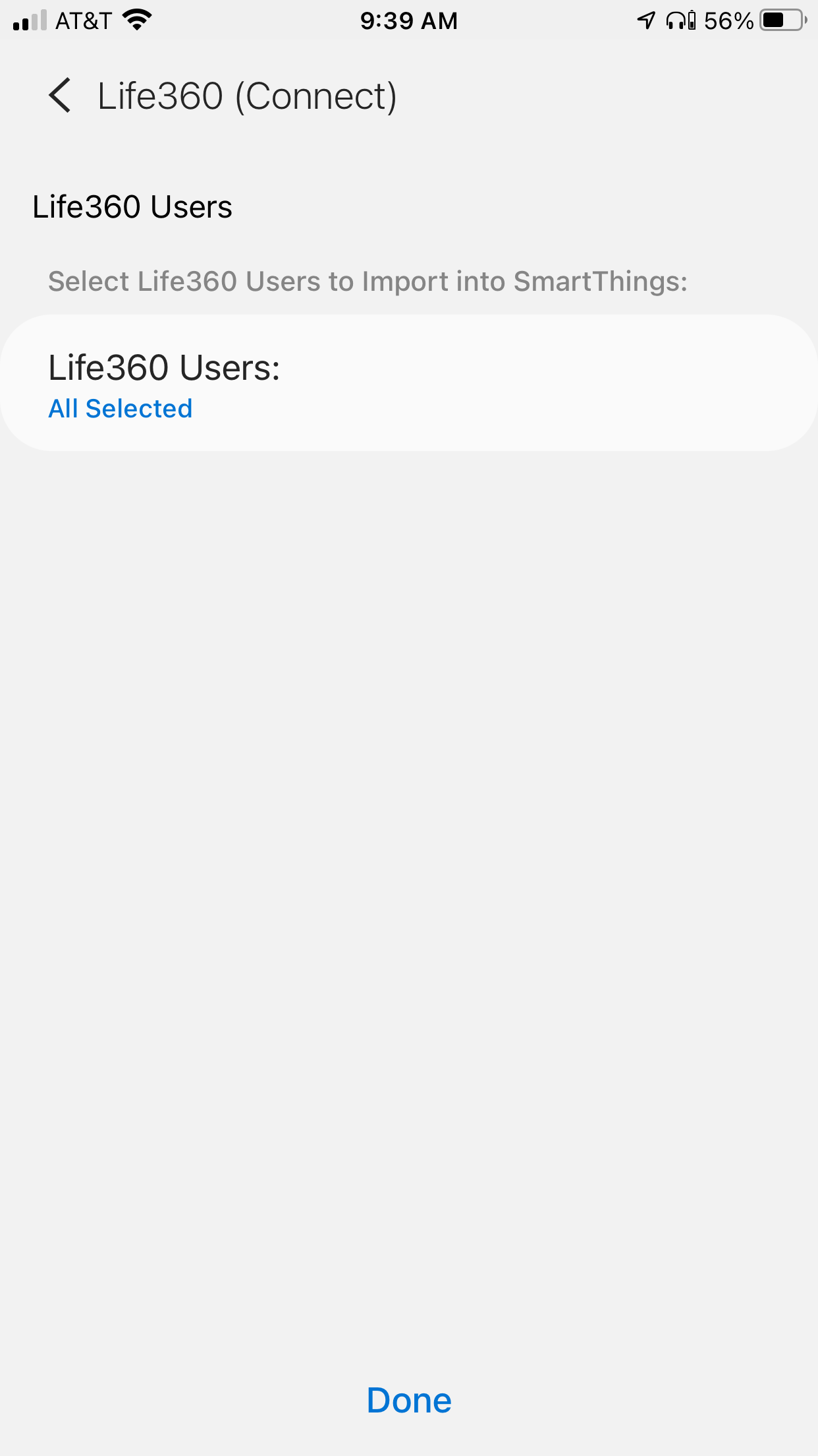

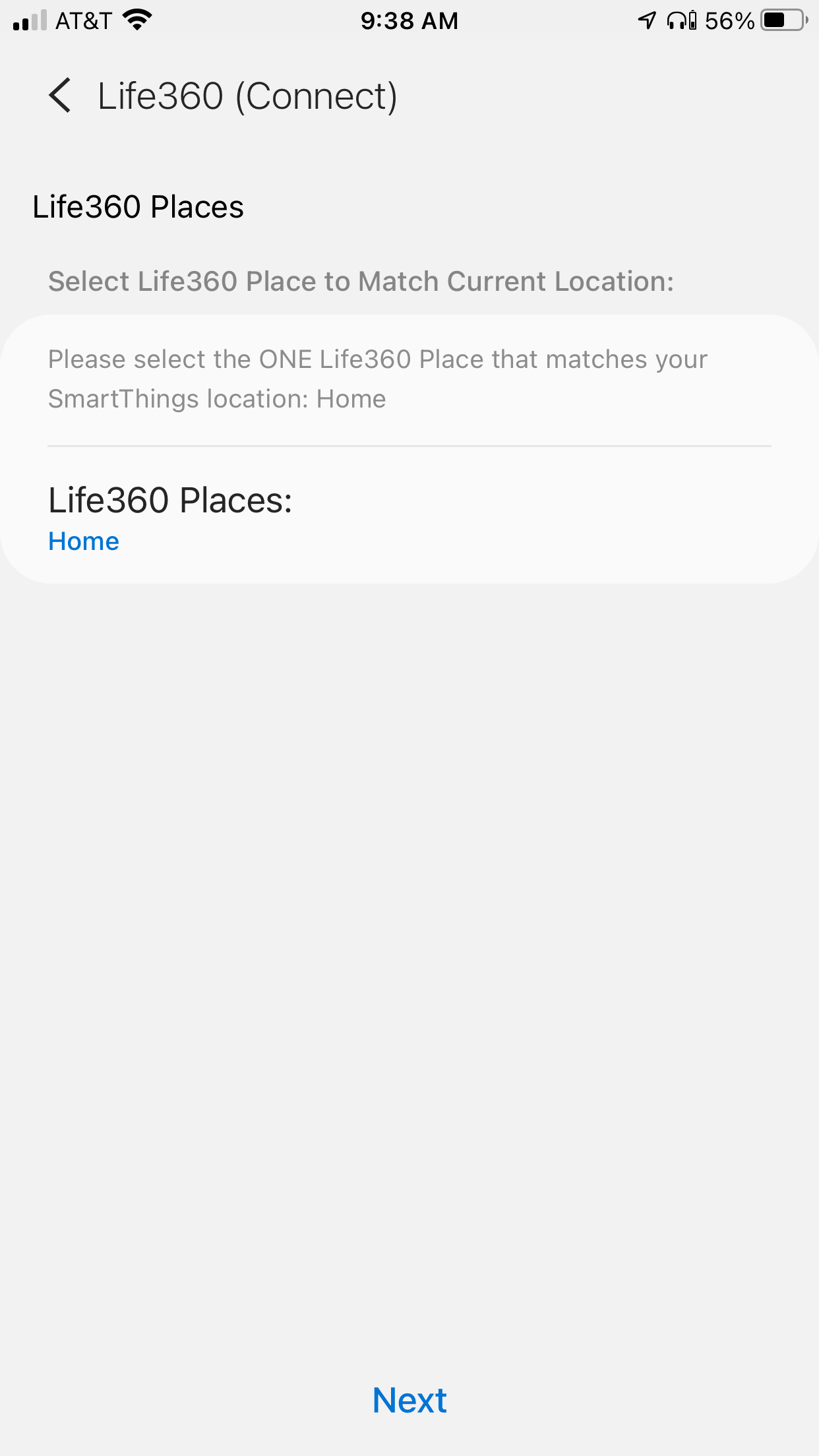

OK – spoke too soon. I get to the select users portion of the install within smart things and whether I pick just me or me and my partner it then crashes and gives me that same screen.
What the hell am I missing? Is there something in the code I’m supposed to be changing?
See screenshots to see where it fails.

Oh how I wish that worked. Sadly it did not. Same error.
Did you create a New Custom Device Handler > From Example > Life360 User?
Once I created the Custom Device Handler in IDE, I was able to get past the “Something went wrong” error message.
Holy crap! It worked. I had NOT. I don’t know if I missed those instructions before or if they just weren’t there. I did create the device handler per your instructions and now it works. Thank you so much!
