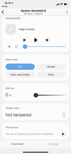

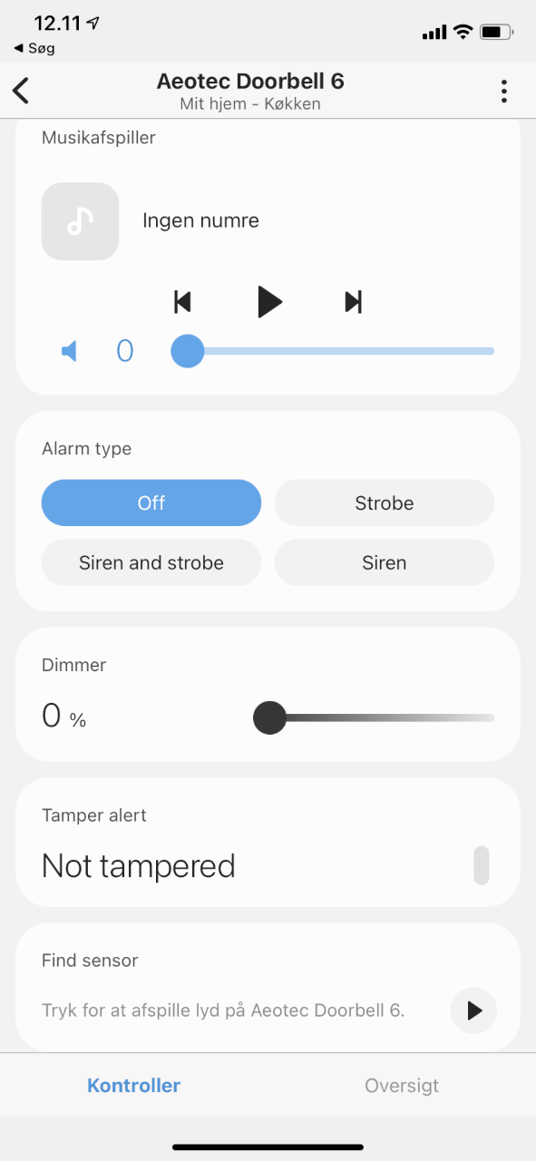

Hi, Awesome handler you’ve provided. But having issues with the button. When pressed, the sounds is really high, even when the Chime is configured to 10% in ST. Also, I cant see the Button in ST. How do I configure the button? I’ve tried pairing it again, and that seems to go weel, but still really loud, and I cant see it in ST.
Mark :slight_smile:
Sorry, I completely missed this post…
It sounds like you don’t have my Aeotec Doorbell 6 Button handler installed so if you install that and then change any of the settings it should in create a child device for the button.
Once you have the child device you’ll be able to use it to change all the settings for the button and detect when the button is pressed.
