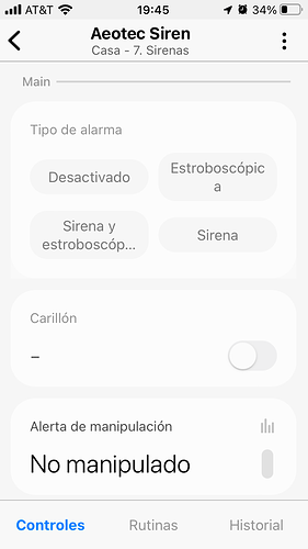

Control screen:

O yes my friend !.. I installed that driver already, my issue is I do not how to control sound to chime a couple of seconds and then turn off… (for example when a door is opened) or trigger emergency sound and turn it off after 3 minutes b.e.
In automation I can only trigger the sound, and there is no option to turn it off, I need to open device control and manually turn sound off. I hope I explained clearly … or maybe I just do not know how to use the driver … :thinking:
