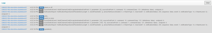

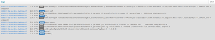

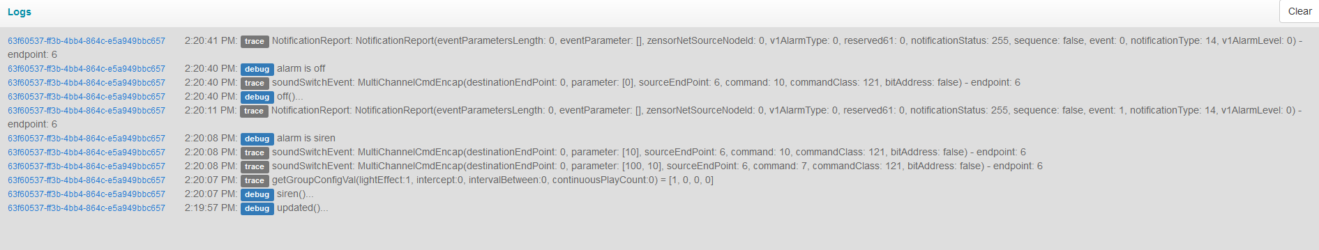

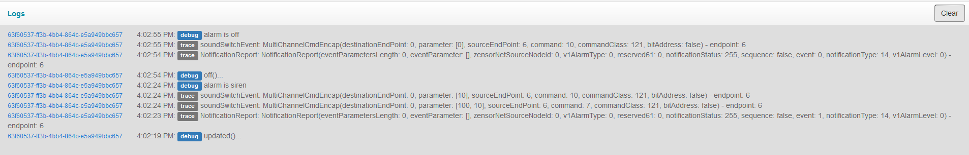

I activated it trough the mobile phone and set the volume at 100 %. Still very low sound
Insert the line below in between lines 701 and 702. Then provide the same logging results as last time.
soundSwitchConfigGetCmd(PLAY_ASSOC.endpoint),
Please find the logging results below
