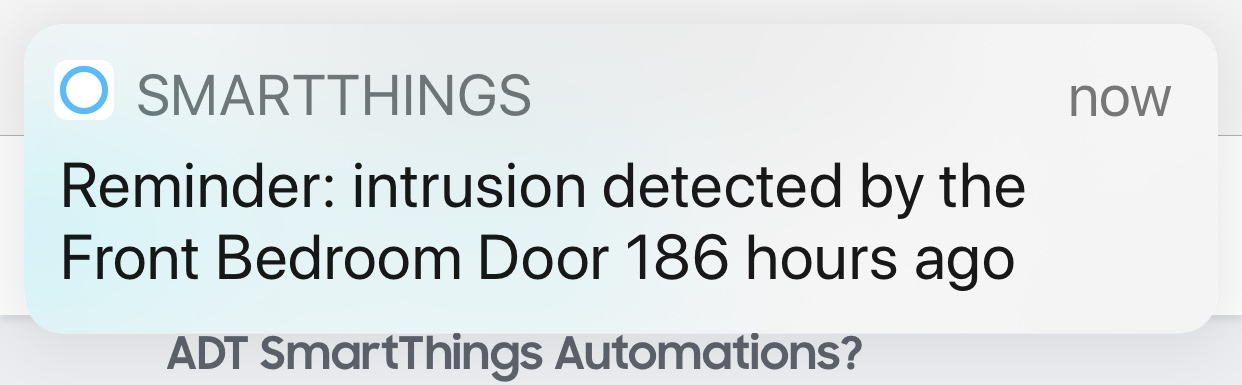

Hey there. I’m relatively new to SmartThings and I’m learning my way around. I’m hoping for a little guidance. I have the ADT Smarthings Panel. Prior to installing the panel I had SHM set up and running. I’m using ADT motion but only have one working ADT door/ window. My remaining doors have ST Mulipurpose. I’m using ADT Tools 2 to Monitor my non-ADT sensors. Here’s my problem. One night I had the alarm armed “stay”and opened a door with the Multipurpose Sensor. When this occurs, I flash lights and send instant messages. (I didn’t realize at the time that the siren does not go off. That’s beside the point and I plan to address with a wireless siren. )
Ever since the occurrence, I keep getting reminders from the Classic App several times a day.
I looked every where even in the IDE trying to clear them. I messaged Samsung Support and the agent kept telling me to go into SHM and acknowledging. They couldn’t understand that once ADT is installed, SHM vanishes from the App. I fear if I delete the SHM App, I’ll break ADT Tools. I really don’t want to factory reset and start over. I did that once already and it’s painful.
Any help would be appreciated
And just like that POOF… SHM showed up in my App today and allowed me to dismiss. I didn’t see any follow ups from support. If they did something, thank you!
