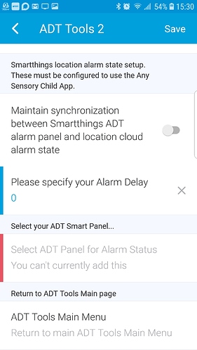

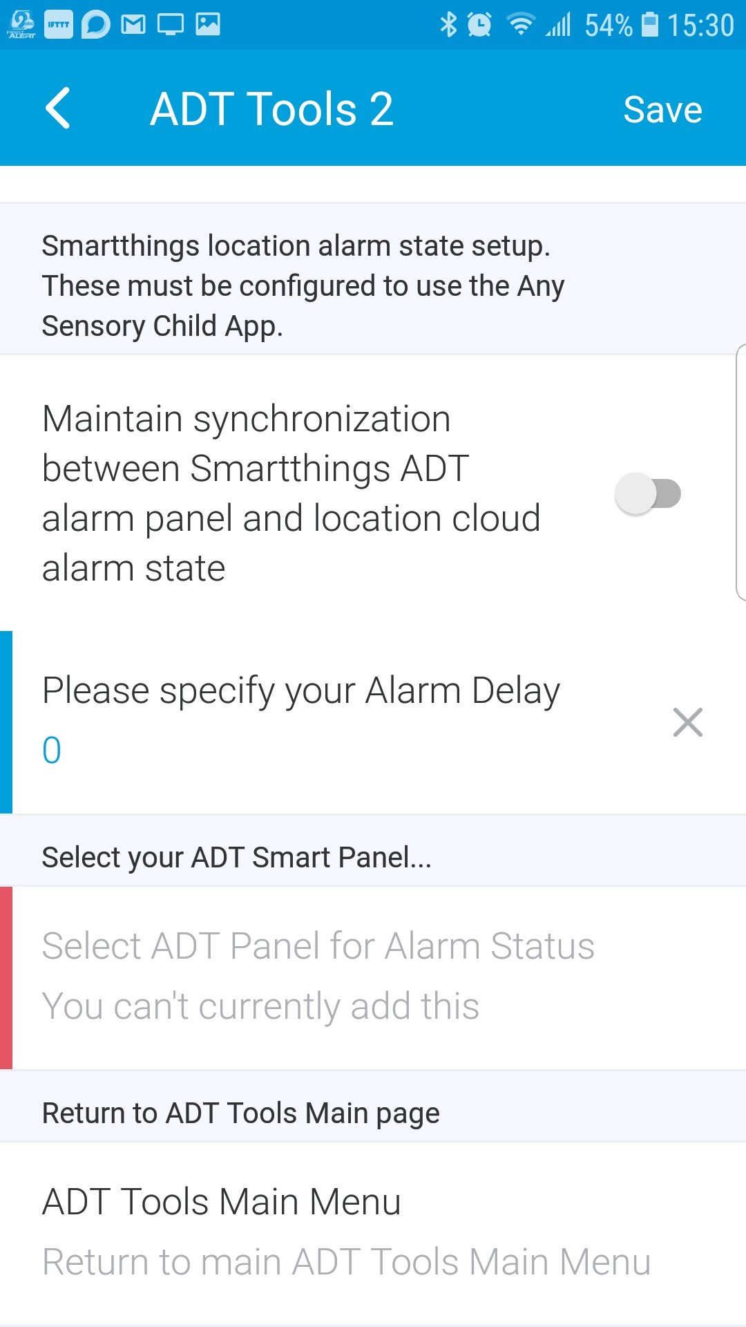

My problem is similar. Maybe someone can help or has run into this problem. When I attempt to select my ADT Panel it is only listed as virtual, and I have no option to select the physical ADT Panel. I have attached a photo for reference.
Any help is greatly appreciated. Thanks in advance!
-Andrew
That looks like the IDE simulator. My suggestion is to use a mobile device and not the simulator. It is known to have issues and not work well from what i understand.
Thank you Maverick for such a quick response. I am still running inti the same issue through the mobile app. Would a hard reset of the panel be in order?
Do you have an ADT Smartthings Panel, live in the US and have it on the location you are trying to setup ADT Tools.
Yes sir. It is in my living room and I am home.
When you lookthrough your devices in the IDE do you see the ADT Smartthings Alarm Panel. It should be de ice type Nortek Panel i believe. Click on it ans see what capabilities it shows what is there.
