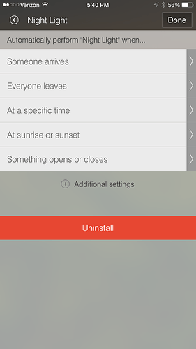

I’m trying to create a new Hello, Home action that only runs when a motion sensor (ST brand, included in my starter kit) senses motion. The motion sensor is paired with the hub and in Things I can see that it is tracking/reporting when motion starts/stops and sensing temperature. It runs perfectly fine in conjunction with SmartApps and 3rd party apps. However, when creating the Hello, Home action, I go to ‘Automatically Perform “Night Light”’ and I don’t see an option for “Things start happening” as countless ST setup guides suggest there should be. See screenshot below:

Re: “When Things Start Happening” and “When Things Quiet Down” specifically: these two criteria require that you change mode when executing the action. Going further, these conditions are currently coded to not execute the phrase if the system is already in the mode being changed to by the phrase. Confusing enough?
We do this to avoid a situation in which the phrase(s) keep triggering over and over again. If you set the action’s “Change the mode to” field then these criteria will appear. @Tyler is right, It’s been like this since it was introduced as an option, so I suspect the mode change was in your configuration previously. Not sure how else you could have done it. Off the top of my head, I don’t think you can set up the particular use case you’re looking for without a mode change. A custom SmartApp could do the trick.

All, thanks for the replies. I can confirm that I get the “Things start happening” option when setting the action to change modes. Coupled with the fact that an action won’t run if it’s already in the mode that the action is set to change to, that really limits their capabilities.

There IS a workaround here… you set up the HHA you want with a dummy mode change, then remove the mode change. Things Quite Down… and Things Start Happening… both keep on working once you’ve removed the mode change.
