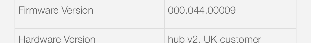

Actually, I think I’m still on the older firmware?
I didn’t see any obvious signs of it being local when I created some Routines this morning. On the other hand I use ‘remains’ in a few Rules and they’ve been claiming they are local since at least the middle of June. Perhaps it is the particular capabilities I used.
that is the latest. Not sure why yours don’t show local :man_shrugging:t2:
I am on firmware 44.9 and newest app version and my automations with the delay are NOT local.

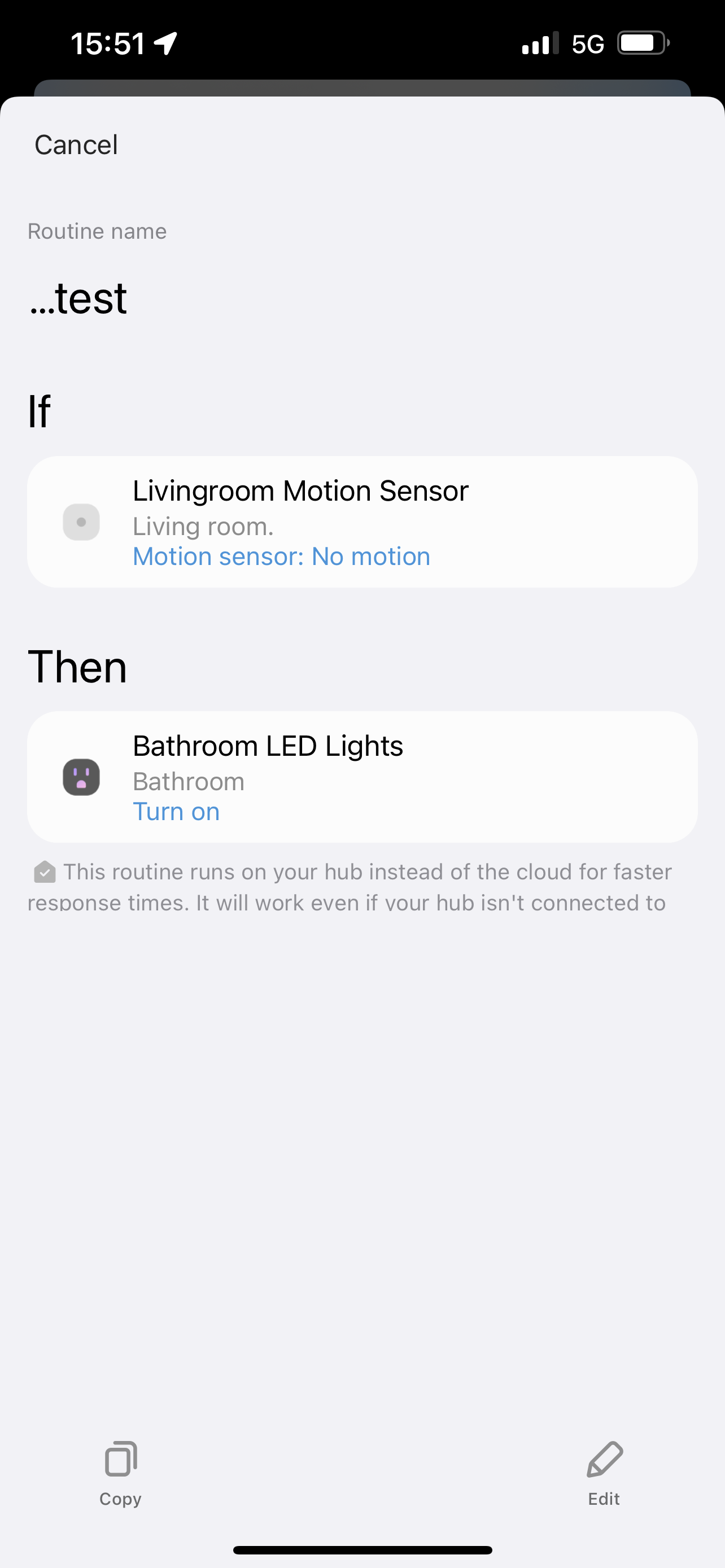

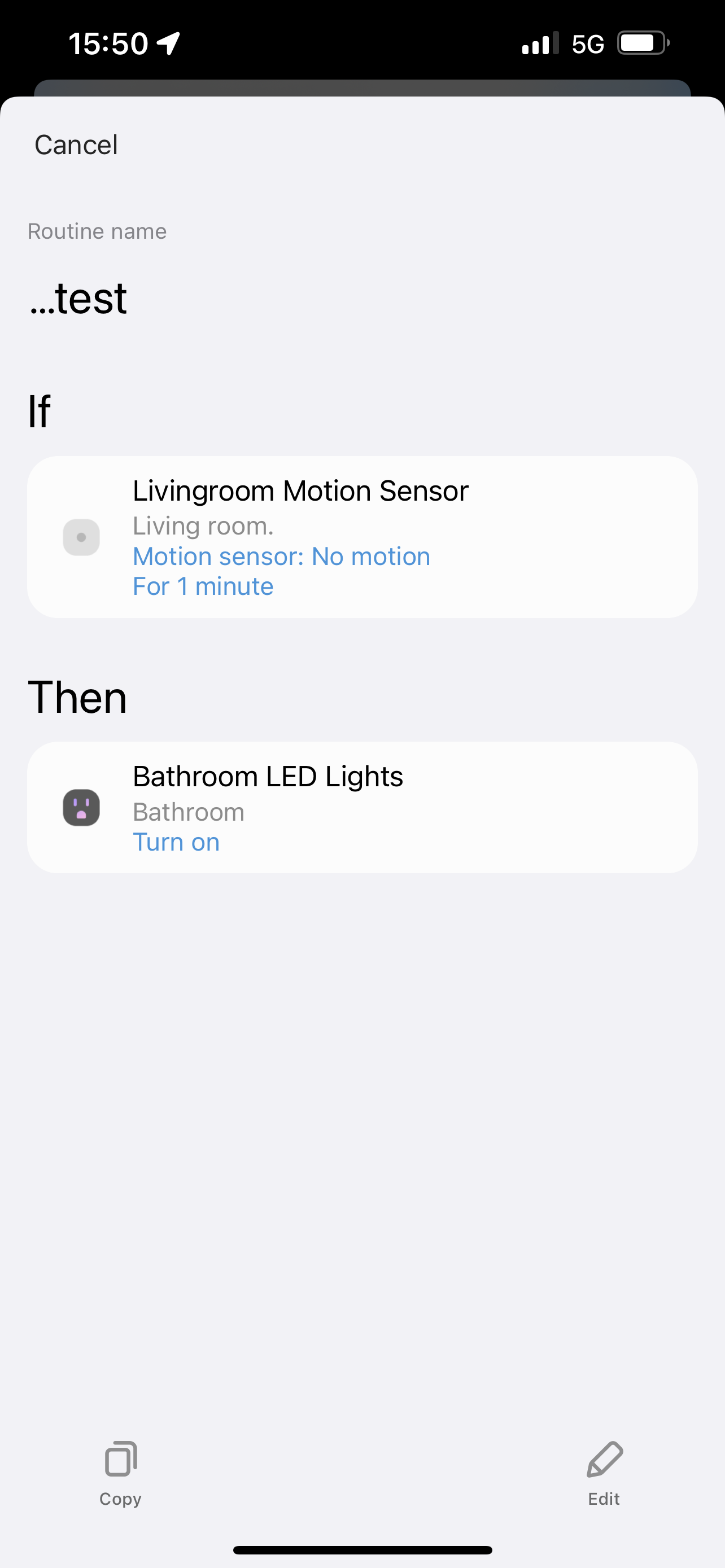

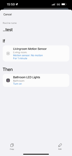

I’m beginning to think they flipped some kind of functionality flag on the back end to disable remains from being local for Routines. I just tried creating an exact copy of an existing local Routine and its no longer showing the local icon. weird!
just below there is saying that your automation is running local.
Check the other screenshot
did you edit and save it again?
I created a fresh routine to test.
Even more annoying.

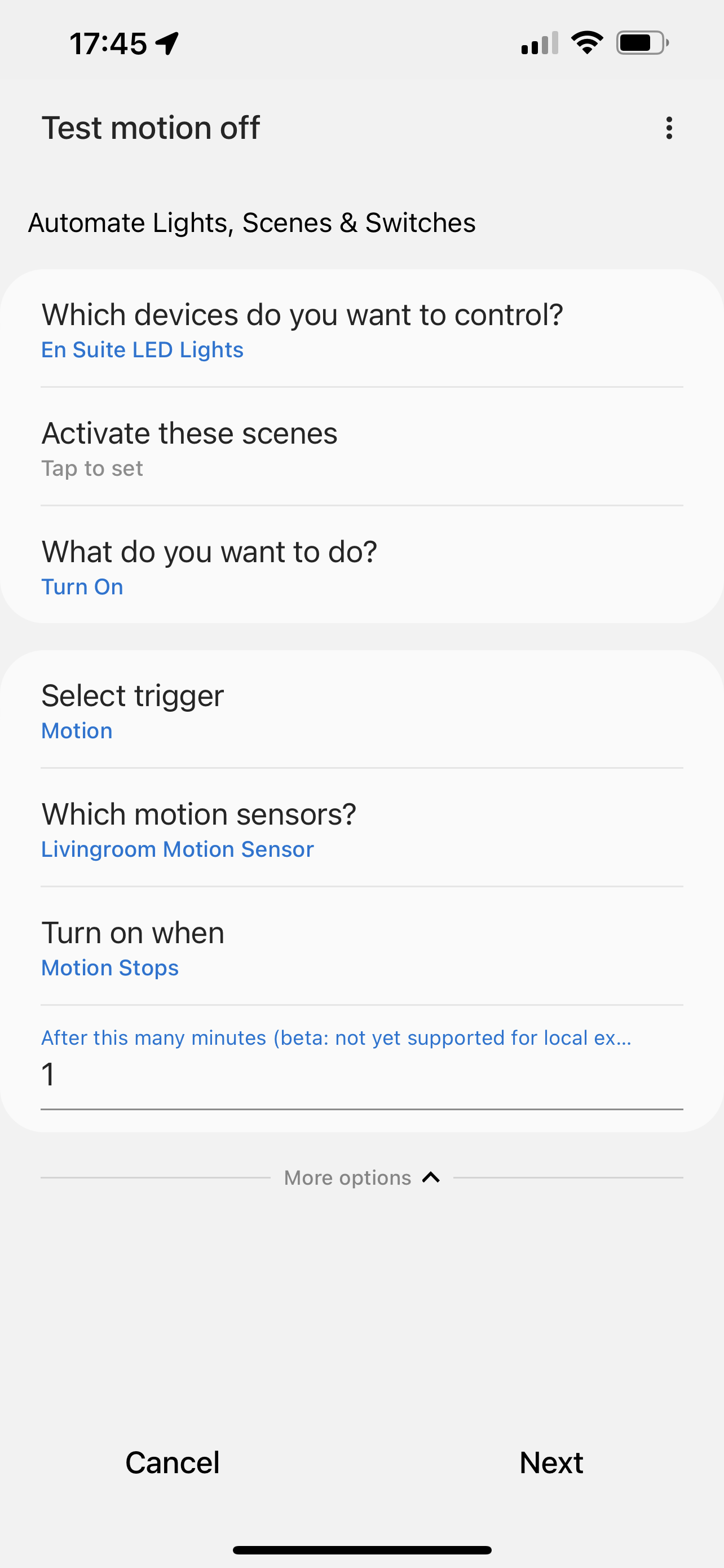

Did the same automation within smart lighting and it’s telling me it’s local.
